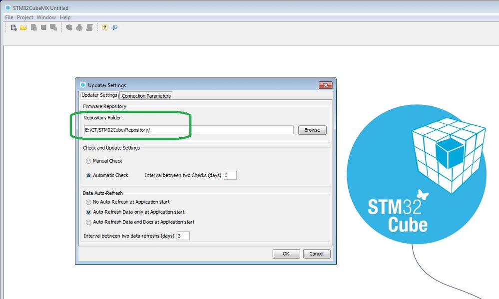

I’ve just installed the STM32F4cube from SetupSTM32CubeMX-4.26.0.exe but I cannot find the “
Hundreds of examples for easy understanding
� mentioned onhttps://www.st.com/en/embedded-software/stm32cubef4.html
or in AN4739.Unfortunately the installer hasn’t installed a folder having a similar name
like STM32Cube_FW_F4_VX.Y.Z\Projects\. .I would be very glad if someone could give a hint how to also instal those examples.

Go into the settings from CubeMX and look where you put the repository
E:\CT\STM32Cube\Repository\STM32Cube_FW_F4_V1.0\Projects\STM32F4-Discovery\Applications\FatFs\FatFs_USBDisk
This is Help -> Updater Settings
If you haven't installed the F4 packages, install those

Dear Clive,
the repository folder mentioned in your post is there but without any software in it. I’ve followed your hint to also download the F4cube “en.stm32cubef4.zip� and viola it contained all the examples I was searching for. Thank you very much for your help.
