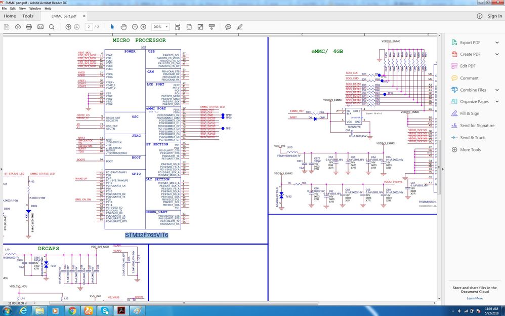

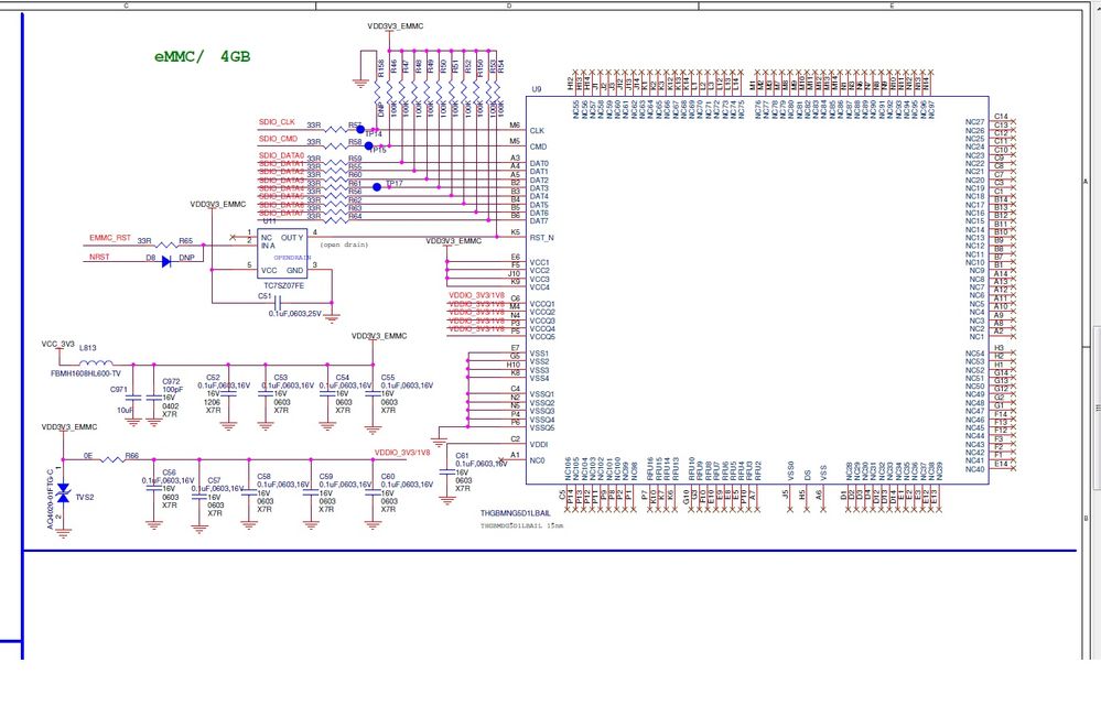

I cannot ship any board to your place , This project is customer , I need online supports
I dint have currently working chip .
I was shared my system design details and part number pls check it and let me know
