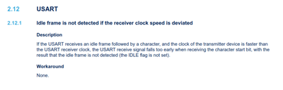

I found in the errara sheet this entry:
Is this somehow related?

> Even the UART reports this noise/frame errors, the message is sampled correctly, the byte has the right value.
UART oversamples each bit. If only one of those samples is off, a noise error is generated even though the bit will be correct. The reference manual goes into detail about this.
