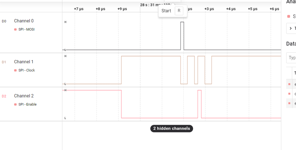

My transmission is all warped. The SCL is generated wrong (it does not start from a high state, and I have CPOL = 1, and there are not enough pulses for 16 bits) and the NSS pin seems to deassert for some reason:
Any help on what is going here would be appreciated. Thanks!

A few things happening here:
  • SCL will be low before the pin is initialized and the peripheral is enabled. Once initialized/enabled, it goes high. Sending a dummy transfer of 1 byte (with CS high) will enable it, among other ways.
  • Your logic analyzer sampling rate is too slow to see all 16 clocks.
  • Not sure why the NSS pin goes high, perhaps noise, but it's best to control this pin manually. The peripheral will set it low and keep it low--not very useful. Better to make it a GPIO pin, set low before transaction and high afterwards.

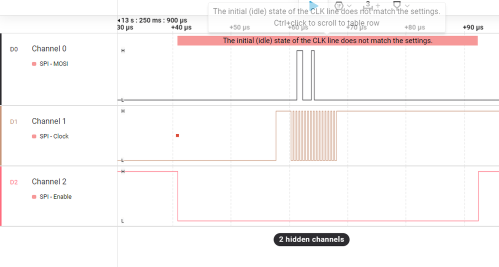

I reconfigured the GPIO pin that was previously being used as the NSS pin as a GPIO output, and set the pin LOW when the call to transmit begins. I ensure that the GPIO pin now being used does not go high until the DMA transfer complete callback executes as I have transfer complete interrupts enabled. I mediate this through the use of a binary semaphore which is taken before the call to transmit, and is released once the transfer completes in the ISR like so:
uint8_t STM32F4xx_SPI_Mgr_Write(uint8_t *pTxBuffer, uint16_t dataLen)
    uint8_t retVal;
    xSemaphoreTake(spiTransactionCompleteSemaphore, portMAX_DELAY);
    DEASSERT_PIN(SPI_GPIO_PORT, SPI_NSS_PIN);
    retVal = HAL_SPI_Transmit_DMA(&hspi, pTxBuffer, dataLen);
    return retVal;
The ISR that signals a new write can occur since transfer completed and CS has been re-asserted:
void DMA2_Stream3_IRQHandler(void)
  /* USER CODE BEGIN DMA2_Stream3_IRQn 0 */
  /* USER CODE END DMA2_Stream3_IRQn 0 */
  HAL_DMA_IRQHandler(&hdma_spi_tx);
  ASSERT_PIN(SPI_GPIO_PORT, SPI_CS_PIN);
  xSemaphoreGive(spiTransactionCompleteSemaphore);
  /* USER CODE BEGIN DMA2_Stream3_IRQn 1 */
  /* USER CODE END DMA2_Stream3_IRQn 1 */
You can see in the attached capture the general logic with de-asserting/asserting the CS pin works, albeit there is some additional delay between the assert/deassert and the completion of the transfer due to HAL library calls eating up a 10-20 microseconds which messes with the analyzer:

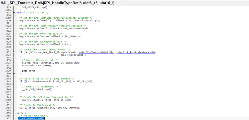

However, for some reason now the call to HAL_SPI_Transmit_DMA hangs indefinitely when the SPI handle typedef used to initialize SPI1, the peripheral in use, is unlocked at the end of the function call. I have highlighted here where this occurs. The errorcode is 0x00 (HAL_OK) when debugging:
