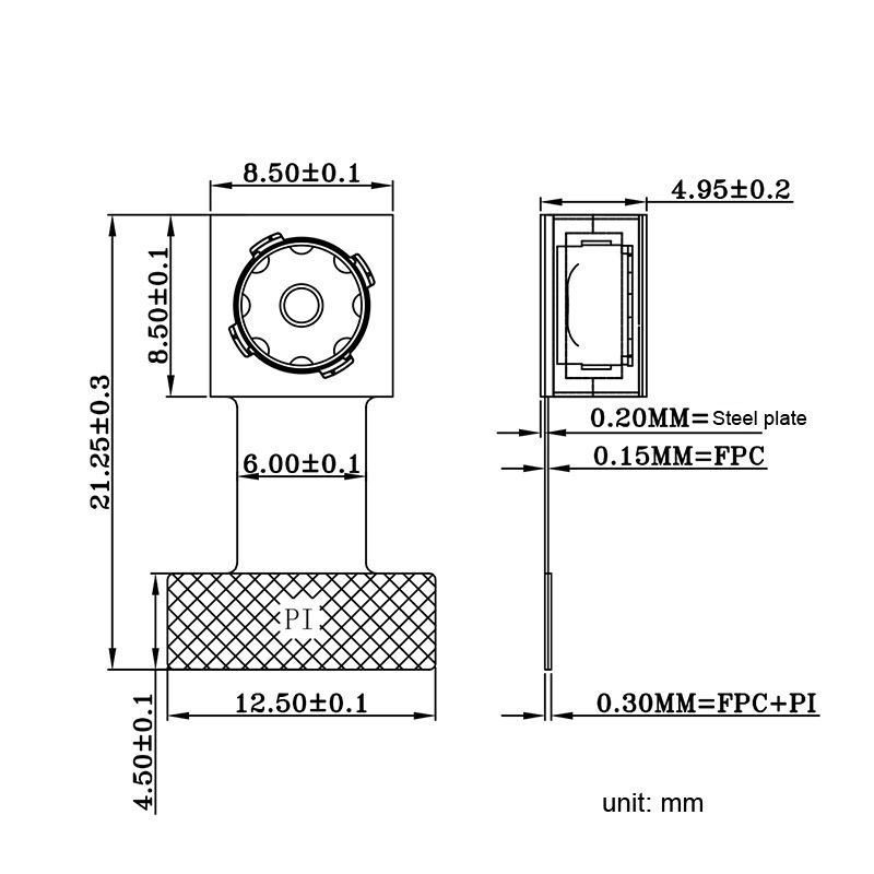

We'd like to tests another sensor, i'll design another FPC with our supplier but i need HDF5640-AF-V2.0 drawings to have the good outline. can you share me HDF5640-AF-V2.0 drawings files pls ?

lol i randomly found this online it says its the same part number but not quite sure
