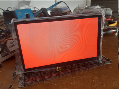

I am starting some test with this module
https://it.aliexpress.com/item/1005002482177244.html
with 7” lcd
I have found only one example that run but with Touchgfx
I have got the same ioc from this example to generate a new code and insert the functions to switch on lcd but still no result
I would like to use the normal functions
BSP_LCD_Init() ;
BSP_LCD_DisplayStringAt(10, 80, buf, LEFT_MODE);
BSP_LCD_DrawBitmap(0, 0, (uint8_t *)(&BackGround0));

Show BSP_LCD_Clear() source !
And try explain why this all when TGFX is more more effective...
>>Is there other parts to compare ?
Convince me the SDRAM is working, write and read-back assorted walking bit test patterns.
We've already seen the LTDC getting working colour data from functional memory. Hey park a suitable bit map in internal flash, or some colour bar test patterns in there.

Now Work!
Changed from
DMA2D_OUTPUT_RGB888 / DMA2D_INPUT_RGB888 / LTDC_PIXEL_FORMAT_RGB888
to
DMA2D_OUTPUT_ARGB8888 / DMA2D_INPUT_ARGB8888 / LTDC_PIXEL_FORMAT_ARGB8888
This set
#define HBP 80
#define VBP 40
#define HSW 1
#define VSW 1
#define HFP 190
#define VFP 22
#define LCD_Width 800
#define LCD_Height 480
#define LCD_Pixels 800*480
#define LCD_MemoryAdd 0xD0000000
hltdc.Init.HorizontalSync = HSW - 1;
hltdc.Init.VerticalSync = VSW -1 ;
hltdc.Init.AccumulatedHBP = HBP + HSW -1;
hltdc.Init.AccumulatedVBP = VBP + VSW -1;
hltdc.Init.AccumulatedActiveW = LCD_Width + HSW + HBP -1;
hltdc.Init.AccumulatedActiveH = LCD_Height + VSW + VBP -1;
hltdc.Init.TotalWidth = LCD_Width + HSW + HBP + HFP - 1;
hltdc.Init.TotalHeigh = LCD_Height + VSW + VBP + VFP - 1;
PeriphClkInitStruct.PeriphClockSelection = RCC_PERIPHCLK_LTDC;
PeriphClkInitStruct.PLLSAI.PLLSAIN = 60;
PeriphClkInitStruct.PLLSAI.PLLSAIR = 2;
PeriphClkInitStruct.PLLSAIDivR = RCC_PLLSAIDIVR_2;
Last source
