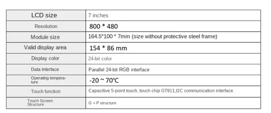

I am starting some test with this module
https://it.aliexpress.com/item/1005002482177244.html
with 7” lcd

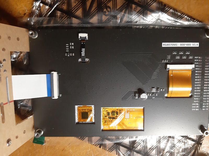

Ok so a FANKE RGB070M1 800x480 V1.4 with AT070TN92 panel
https://www.beyondinfinite.com/lcd/Library/Innolux/AT070TN92.pdf
Timing clocks in here
stm32F429BI-test2\Core\Src\stm32f4xx_hal_msp.c
You've got LTDC initialization in main.c via MX_LTDC_Init()
Back + Active + Front
Horizontal 64 + 800 + 210 = 1056
Vertical 23 + 480 + 22 = 525
Sync needs to come out of the back budget
Horizontal sync 1 - 40
Vertical sync 1 - 20
LTDC has a counter, hence the "accumulated" value so you can hit each count

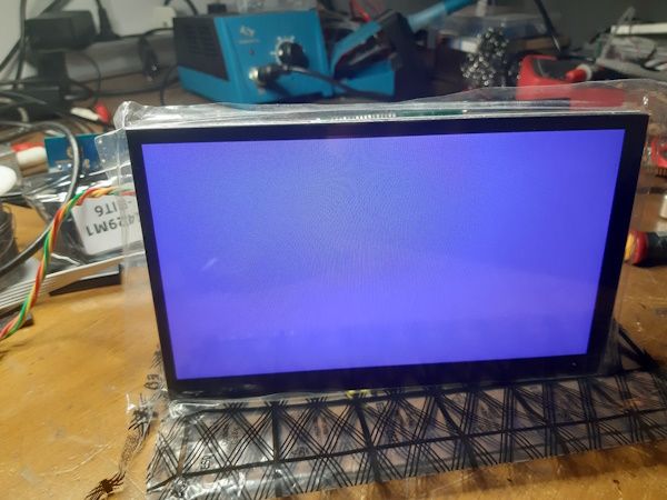

near to the final result but why it is blue ?
the main code:
HAL_GPIO_WritePin(LCD_BACKLIGHT_GPIO_Port, LCD_BACKLIGHT_Pin, GPIO_PIN_SET);
BSP_LCD_Init();
//osDelay(1000);
#define WHITE 0xFFFF
#define BLACK 0x0000
//Paint_NewImage(800, 480, 0, WHITE);
BSP_LCD_Clear(WHITE);

ok, Tesla DeLorean
I will test tomorrow morning
Tesla DeLorean, Your set not RUN
This RUN and show a blue screen
PeriphClkInitStruct.PLLSAI.PLLSAIN = 60;
PeriphClkInitStruct.PLLSAI.PLLSAIR = 2;
PeriphClkInitStruct.PLLSAIDivR = RCC_PLLSAIDIVR_2;
#define HBP 80
#define VBP 40
#define HSW 1
#define VSW 1
#define HFP 190
#define VFP 22
#define LCD_Width 800
#define LCD_Height 480
#define LCD_Pixels 800*480
#define LCD_MemoryAdd 0xD0000000
hltdc.Init.HorizontalSync = HSW - 1;
hltdc.Init.VerticalSync = VSW -1 ;
hltdc.Init.AccumulatedHBP = HBP + HSW -1;
hltdc.Init.AccumulatedVBP = VBP + VSW -1;
hltdc.Init.AccumulatedActiveW = LCD_Width + HSW + HBP -1;
hltdc.Init.AccumulatedActiveH = LCD_Height + VSW + VBP -1;
hltdc.Init.TotalWidth = LCD_Width + HSW + HBP + HFP - 1;
hltdc.Init.TotalHeigh = LCD_Height + VSW + VBP + VFP - 1;
    run
HBP80 AccumulatedHBP40
VBP40 AccumulatedVBP40
HSW1 HorizontalSync0
VSW1 VerticalSync0
HFP190 AccumulatedActiveW880
VFP22 AccumulatedActiveH520
LCD_Width800 TotalWidth1071
LCD_Height480 TotalHeigh543
