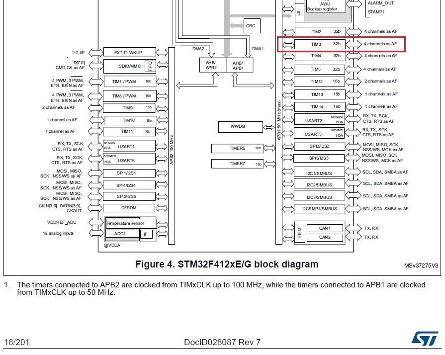

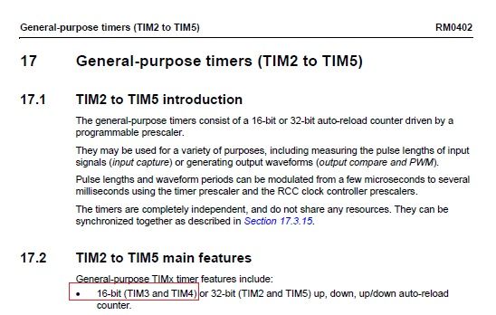

The reference manual (RM0402, DocID028087 Rev 7, Fig 4) shows TIM3 as a 32 bit timer. However, the in the description in Section 17.2, TIM3 and TIM4 are described as 16 bit timers.
Is this a mistake in Figure 4 ?
Thanks

TIM3 on STM32F4 is a 16 bits. The 32-bit timers are TIM2 and TIM5.
That's the datasheet, not the reference manual.
Options
2021-12-12 9:15 PM
HW never lie, go debug mode, run and stop the code, use hw register peripheral view to enable timer clock in RCC, theb write a 32 bit value in TIM.CNT and voila, you know....
