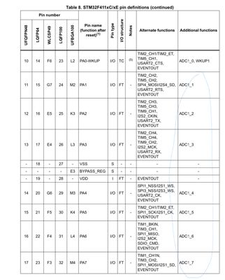

Hi, I'm working with a STM32F411RE6 on a pcb and i've noticed that trying to read an input from PB5 and PB6  just returns 0. I've tried fiddling with the registers eg. setting them to analog input mode, pullup, pulldown and left floating but none of it seems to make a difference. my guess is that is has to do with the ADC. for reference below is a screenshot of my teleplot grah showing various pin analog input

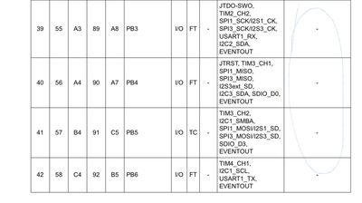

PB5 and PB6 on STM32F411 are not connected to ADC. See "pin definitions" table in STM32F411 datasheet.

Thanks @waclawek.jan  for the contribution, Indeed
changed the label used from L4 to F4 series .
