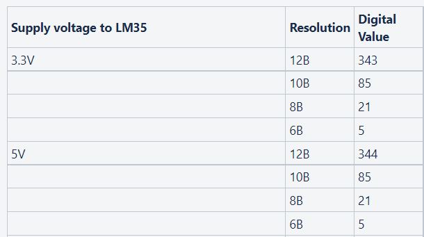

I am trying to get LM35 temperature sensor value using STM32F411RE. When supply voltage fed to LM35 is 3.3 V, the correct digital data is produced. But when 5V is fed as supply to LM35, the digital values produced are the same as those when 3.3V is supplied. Do I have to configure the reference as 5V anywhere in the code? or Is there any way to get proper digital values for 5V supply as well? Please help me out.
0693W00000JOxtTQAT.pngCode:

Of course, you will get the same results corresponding to the output voltage of the LM35. This output voltage is essentially independent of Vs of the LM35 and follows the function 10mV*temperature, where temperature is used in degrees Celsius.
So it doesn't matter whether you supply the LM35 with 4V or 30V - it's just not recommended to operate it below 4V, as TI's datasheet says.

Thanks for the reply @Peter BENSCH​ .
But when we make a conversion of digital value (say 343) to Celsius for 3V, the formula used is
temp=(digital*330)/4096------------- I get 27 C which is the correct temperature value.
whereas for the same digital value (343), the formula used is
temp=(digital*500)/4096-------------- I get 41 C which is the wrong value.
Now I understand where your mental knot is, but first for clarification:
  • The LM35 outputs an absolute voltage according to the given formula Vo=10mV*temperature [°C].
  • The ADC must therefore also perform an absolute measurement at this voltage, but can only do so relative to its reference voltage.
Now comes the solution to your error:
In your formula you do not have to use the VDD of the LM35, but the reference voltage of the ADC. The STM32F411RE in the LQFP64 has the VREF+ available via pin 13, so if you have connected it to VDD=3.3V, you clearly have to multiply by 330 (or better the current value of your voltage) in your formula.

"digital" in your equation is VREF provided to the STM32 ADC. Probably it is 3.3 V and so it is independent from the supply of the LM35
@Peter BENSCH​ ,
you mean to say, whatever might be the supply voltage given to LM35, the VREF will be the voltage supplied to ADC on STM32. Is it so? If yes, how do I make that internal VREF as 5V?
By this, did you mean to say that VDD=3.3V on CN6 should be connected AVDD (pin 13) on CN5? Isn't AVDD itself a 3.3V supply?

Thanks for the clarity.
I didn't know that VREF could not go beyond VDD.
>For what reason you want to set VREF to 5V?
There is no particular reason, just wanted to operate the ADC at voltages other than 3.3V and check for digital values produced.
