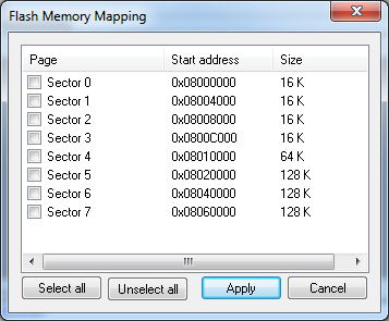

Can anyone confirm what the Flash sector sizes are on this MCU version?
All documentation lumps the F411xC with the F411xE even though the former has 256kB of flash, and the latter has 512kB. The stm32f4xx_hal_flash_ex header defines the same number of sectors as the F411xE, so I'm assuming all the sectors for the STM32F411CC are just half of all the sectors outlined in the datasheet (RM0383 / DocID026448 Rev 1 - page 43).
The ST-LINK tool > Erase sectors option matches the datasheet, which is misleading as it shows a total of 512kB when counting up each sector!
I just want to be 100% certain. My guess is that the sectors are using the same Start address but have the following sizes:
  • Sector 0: 8K
  • Sector 1: 8K
  • Sector 2: 8K
  • Sector 3: 8K
  • Sector 4: 32K
  • Sector 5: 64K
  • Sector 6: 64K
  • Sector 7: 64K
Thanks!

Posted on July 11, 2017 at 02:28
Pretty sure it's not that, the two parts likely share a common die.
16 + 16 + 16 + 16 + 64 + 128 = 256

Posted on July 11, 2017 at 12:04
So this is what I originally thought, but this would mean there are only sectors 0 - 5, but the ST-LINK seemed to allow me to erase sector 7 without warning...
If there are only 5 sectors then the header is wrong as it assumes it has the same as the F411xE, and the ST-LINK is doing something funny by allowing me to believe I can erase a sector 7. Or there are the same number of sectors at half capacity..
A long winded test I guess would be to set all memory in an address range to a non-reset value, then reset a sector and just count the number of bytes that have been reset.
I would imagine if a sector truly doesn't exist a call to HAL_FLASHEx_Erase() would return a sector error, and it's possible the ST-LINK ignores it (but unlikely?) so I can try a manual call to the above along with a call to erase a sector that I know definitely doesn't exist on the xC/E (say 9) and see what happens..

Posted on July 11, 2017 at 13:07
I'm with your now, makes perfect sense!
Consider this solved! :)
