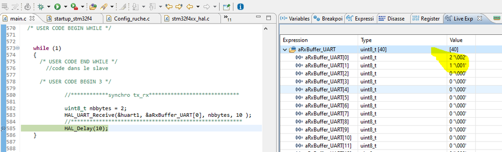

I made à very simple program herunder on master and slave. between master and slave I have a cable with 30cm lentgh
Slave program
    while (1)
      /* USER CODE END WHILE */
	//code dans le slave
      /* USER CODE BEGIN 3 */
  	      //************synchro tx_rx*****************************
  	      uint8_t nbbytes = 2;
  	      HAL_UART_Receive(&huart1, &aRxBuffer_UART[0], nbbytes, 10 );
  	      HAL_Delay(10);
Master program
  while (1)
	//code dans le master
  	      aTxBuffer_UART[0] = 0x1 ;  // 10101010
  	      aTxBuffer_UART[1] = 0x2 ;  // 01010101
  	      HAL_UART_Transmit(&huart1, &aTxBuffer_UART[0], nbbytes, 10 );
  	      HAL_Delay(10);
Data ares sent correctly
Reception is all time bad.

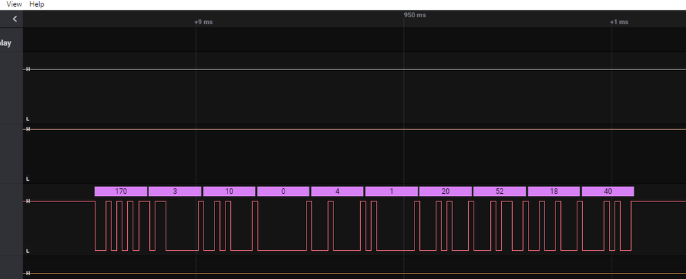

Joel14

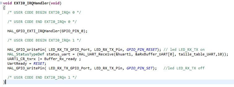

I try to use another pin connected to Rx pin. this second pin PB0 is in GPIO_EXTIO mode.
I put the HAL_UART_RECEIVE() function in the EXTI0_IRQ handler

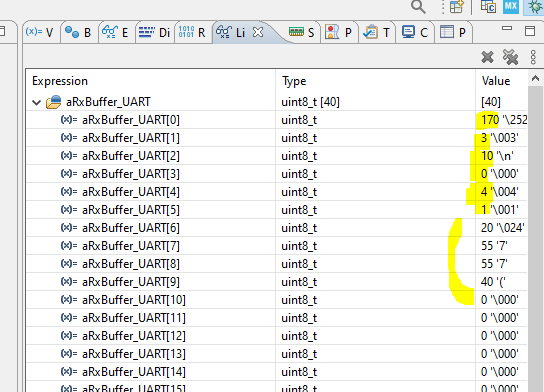

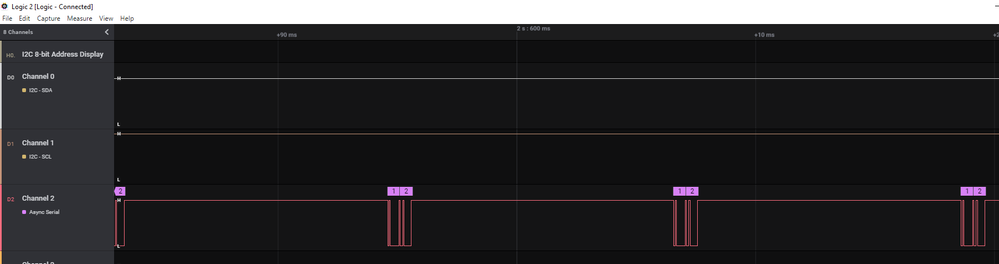

0693W00000GXbTFQA1.pngreceived frame
0693W00000GXbUNQA1.pngreceived frame in rx buffer is allways good whitout rotation in the data. the last bytes in the frame is the time. this is normal that bytes changes beetwen the 2 captures.

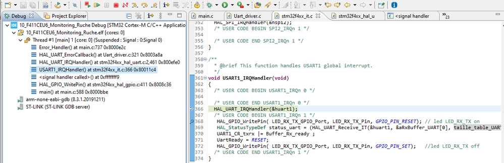

Joel14

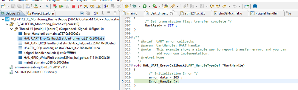

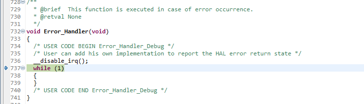

I write a second message because I don't understand why I cannot use UART_INTERRUP because I have a error handler. due the error handler i use the prvious solution with a second IO in interrupt mode.
Joël
