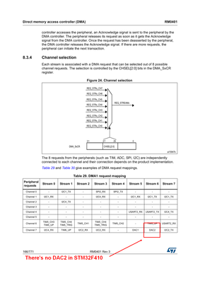

STM32F410 RM DMA table contains nonexistent DAC2
waclawek.jan

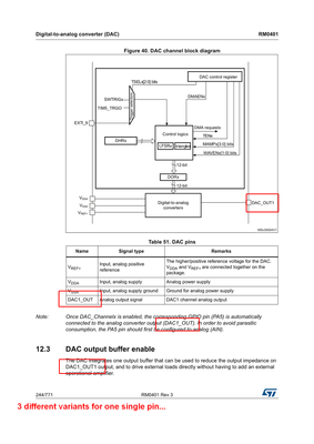

Also, the only DAC pin marking is so sloppy that this can be found on one single page:
I'd recommend to go through all DAC-containg DSs and RMs and unify nomenclature. It's okay (and IMO preferrable) to call the single DAC module DAC1 and its single pin DAC1_OUT1, as long as it's consistent across all DS and RM. Similarly, the DMA request signal's name shall consistently reflect that it comes from the 1st subunit of 1st unit (DAC1_1 or similar).

Hello @waclawek.jan
Thank you so much for sharing this typo with as. I will escalate it to our Doc team for correction under internal ticket number 186028. For the naming recommendations, I will escalate it to the same team.
Best Regards.
