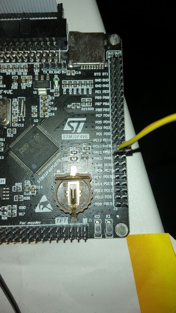

Hi, I am trying to communicate on CAN BUS, I have previously succeeded in doing so with STM32F103C8 and STM32F091RC, but I cant make it work on STM32F407VET It does not trigger its interrupt on message receive. What could be the difference on this MCU? Do I need to enable something different?
MCU clock 168Mhz, APB1 42Mhz, CAN BUS speed is 100000bit/s, enabled "CAN1 RX0 interrupts" in NVIC, code:

2021-03-11 10:30 PM
Probably You have problem with settings of SystemClock.
You have on the board STM32F4VE 8 MHz external resonator?
If yes, please change value from RCC_OscInitStruct.PLL.PLLM = 25 to RCC_OscInitStruct.PLL.PLLM = 8,
Best Regards,
Slawek

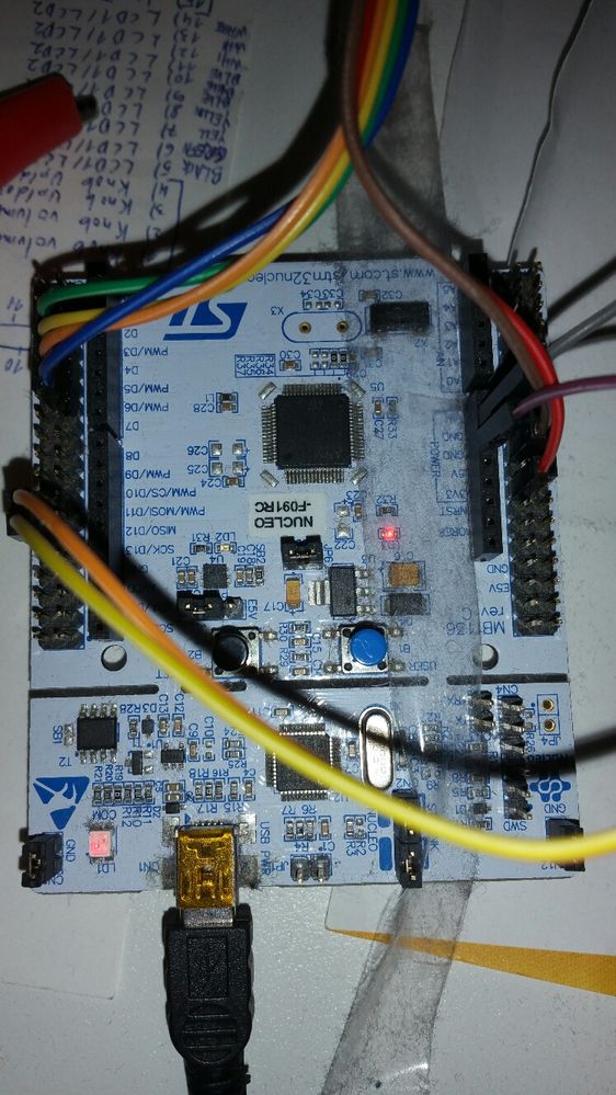

2021-03-07 8:58 AM
Do You have correctly settings hardware (pins) and interrupt for CAN1?
2021-03-08 1:13 PM
Tried swithich RX TX, different pins allso same, tried sending can message, on sending I noticed that other devices wakeup but do not get a message, sending corrupted message? does it use correct APB1 mhz?

2021-03-09 1:47 PM

2021-03-10 12:13 PM
Does not seem to make any difference, interrupt does not trigger on message pending.
STM32F091RC working ok on same can bus...
2021-03-10 12:22 PM
Do You use external transceiver CAN?
You connect directly PIN CAN1 from STM32F407 to STM32F091?
