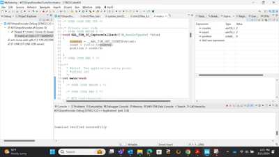

Good afternoon community,
I am trying to implement the Input Encoder in
STM32F407G Discovery board.
I implement all things, but I am not able to generate desired the output from the board.
I get counter/count/position value as zero.
Can you please help me to implement the Input encoder?
Here is code for your reference, if any reference code you have then please provide me.
Thank you.

> void hal_tim_IC_CaptureCallback(TIM_HandleTypeDef *htim)
The correct callback function is HAL_TIM_IC_CaptureCallback. Function names are case sensitive.
The "position" variable should probably be defined as volatile if it will be accessed in the main thread.
If that doesn't work, ensure the pin assignment is correct and ensure the signal is making its way to your board.

Thank you team,
I change all things as you say,
But still i face issue about it.
I change the Phase value but still it is show same value "2". in both variable,
and position value is not updating. Can you please help out.

I would recheck your wiring. Use a logic analyzer to verify the signals are as you think they are. I can't do this part for you.
