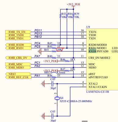

I have created Ethernet custom board using STM32F407 + LAN8742A attached is my schematic design based on Nucleo board for STM32F429ZI.
on my custom board MX_LWIP_Init is getting error in HAL_ETH_Init in following section.

Also check my PCB file to verify the placement and routing and suggest the changes if there are any files attached.
the application I configured is working on nucleo board but the same configurations not working on custom hardware. attached the application used for testing
Hi @Piranha, @Tesla DeLorean  Please help me resolve this issue this is my 3rd iterations on hardware but facing the same issue in all. this time I matched everything with nucleo board BOM.

also, after a quick check of your design I find that it is not compliant with the schematic of the Nucleo F429 which embedded the same PHY.
the RXFER/PHYAD0 pin has 33-ohm resistor and in our schematic, we have a 10K resistor:
Nucleo schematic
check also if the Capacitor values associated to your crystal oscillator is compliant because they can cause the PHY to not initialize properly hence not being able to de-assert the software reset bit.

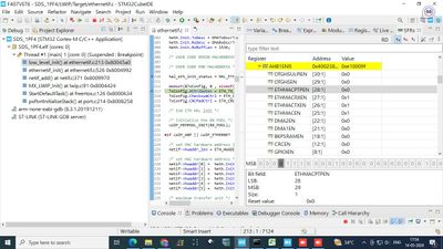

3. Tried checking DMA setting but controller goes in Error_handler after finishing HAL_ETH_Init() function

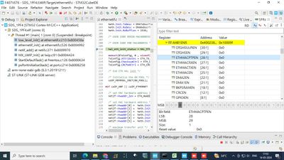

2. checked  ETHMACxxEN bits in RCC_AHB1ENR are set or not
Before calling HAL_ETH_Init()
 after calling HAL_ETH_Init()

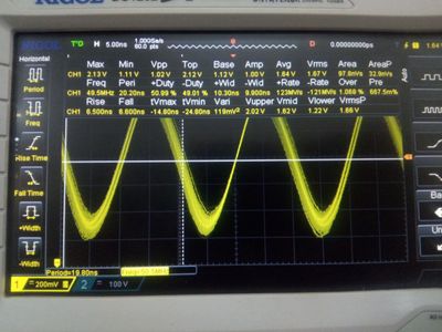

 Changed the Resistor value for RXFER/PHYAD0 pin to 10K but issue is still same. on nucleo board after successful init I can observer 50MHz clock on Refclk0 pin but in case of custom board is not observed.

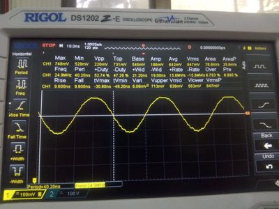

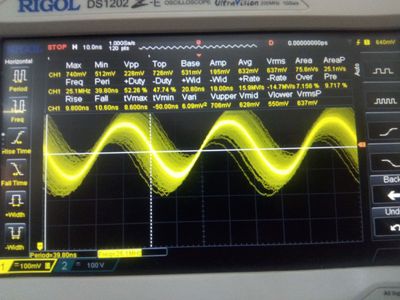

Following is the Clock signal observed for LAN chips on custom board with same of capacitor  value (30pf) similar to nucleo board.
with similar part number for oscillator for LAN as nucleo board following is observed on nucleo board

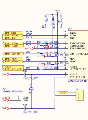

 I request you to review the layout also to check weather the problem is in board or not so that I can resolve this issue as soon as possible.

Might not be relevant, but what is the state of your ethernet NRST pin?
This could either be its own GPIO output, or you may have linked it to a push button? NRST should be controlled in user code to enable the PHY.
It might be that your board has an incorrect pull up / pull down, or you haven't implemented the NRST properly. Or there is a slight difference with this and the Nucleo.
Apologies if this isn't the case, your schematic doesn't show all the NRST.
