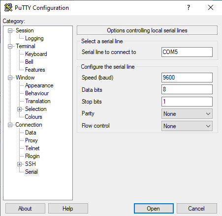

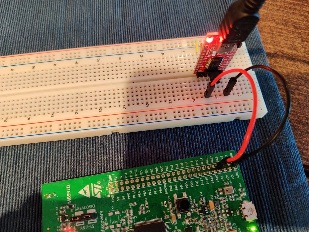

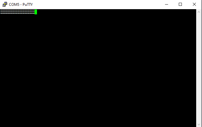

STM32F407 UART problems. PuTTY, FTDI USB to TTL converter

Hi clive1, I paste my code in from a windows machine. WIN10 as I did before in my other posts as well. I can also see that the software modifies my code. I set every register bit in its own line of code. However, the code shown above collected all register manipulations with an OR.
Anyway, let me attach the main.c file which contains the source code.

I'd use 16 over-sampling, USART1->BRR = 0x683;
And loop on TXE before sending
void funcUARTSend()
  int i;
  for(i=0; i<10; i++)
     while((USART1->SR & 0x80) == 0); // wait for TXE to assert
     USART1->DR = 0x55;
Hi clive1
I forgot to mention that I am using the discovery board, so you may already have known the issue upfront without going through my code. Sorry for that.
I eventually found the problem. PA9 and PA10 on the discovery board are already used for other hardware purposes, so there is a conflict when using PA9 as a TX for UART. I configured USART1 using PB6 and PB7 which are not used on the discovery board. I get the proper transmission now and everything works as expected.
