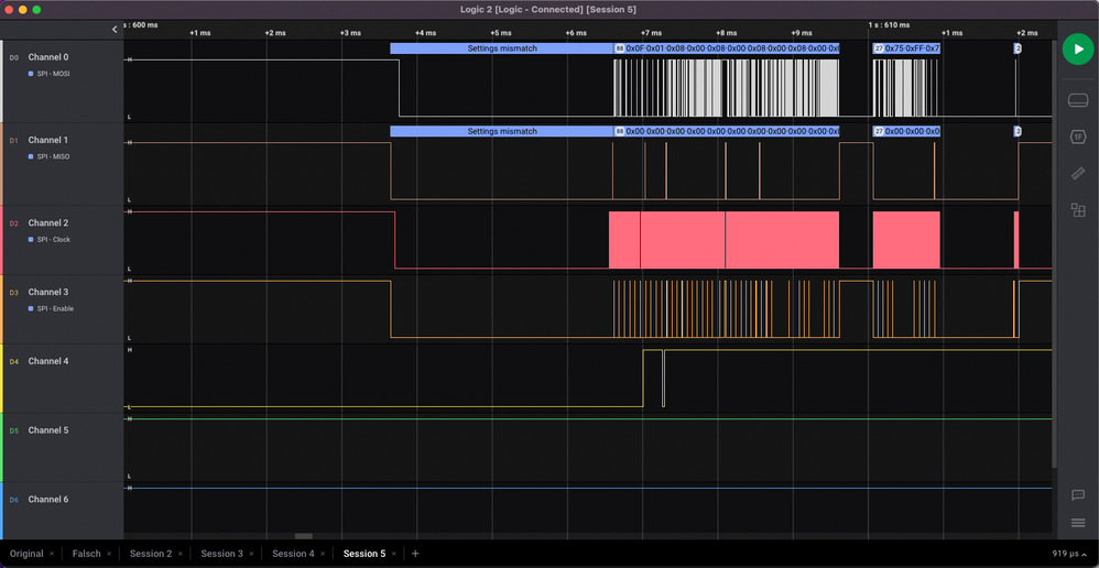

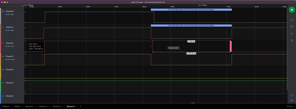

I have problems to initialize my SPI1 interface, and send a request. My Logic Analyzer Says that, after powering without a STLink.

Now when I run my code with a STLink and Run:
So, can any one help me to try out the Problem?

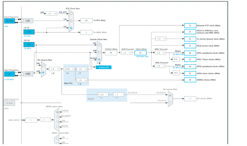

My Clock Config:
0693W00000QKClhQAH.png(I tested a blink example, that runs fine without STLink, and 1 seconds pulse)

and the clockrate is 8MHZ and the same code with stduino+platformio works without problems… and by the spi things, are many different….
