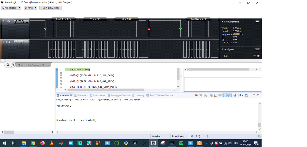

my first attempt to program a LCD1602 via I2C1 on my STM32F407 discovery board failed miserably. I do not get the start condition generated, which means I never get the Start bit (SB) set in my status register. It seems that I am missing something fundamentally in my setup. Intention: STM32F407 is master, LCD is slave. The I2C module on my LCD seems to be the PCF8574, with address 0x27 (A0, A1 and A2 are logic high).
Any sharp eyes around that can spot my mistake? Thank you.
EDIT:

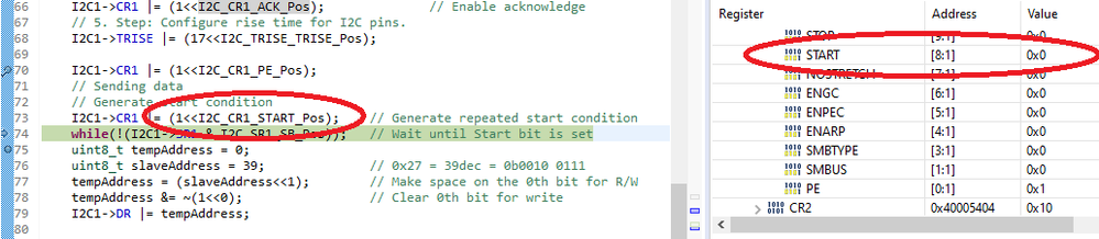

My code get stuck in line 42, where it never leaves the while loop.
My code:

Oh wait. I am wrong on this one. On the 9th bit, an ACK is considered a logic low on the SDA line. So in fact, the address phase is acknowledged. And so is the data transfer of the 0x64 on the data line. On the 9th bit, SDA is logic low as well.
So it seems that my I2C is working as intended. That's great. :)
Now I just need to understand how to control the LCD with that. :)
Thanks for your support :)

> while(!(I2C1->SR1 & I2C_SR1_SB_Pos));
You're using I2C_SR1_SB_Pos where you should be using I2C_SR1_SB. This mistake occurs on a number of lines both before and after line 42.

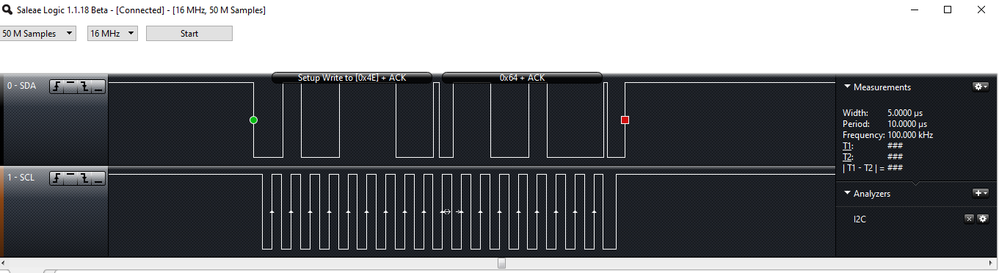

Thank you TDK. This helped solving one problem. I am now leaving the while loop after a true condition as I should be. But I still cannot seem to get the I2C working. I hooked up my logic analyzer while the breakpoint is set to writing the data register, and I seem to have a fundamental problem here. Although I intended to set up the SCLK frequency to be 100kHz for SM, I seem to have a SCLK of 200kHz, where Thigh is 2,5us instead of 5us. This is mystic to me! :\ I am using HSI with 16MHz and set 80 into the CCR register. 16MHz/100kHz = 160 as a full period. Half of that is Thigh, thus Thigh=160/2=80. It seems like I am running twice as high as I should be.

So double CCR. Read the CCR register description to find out your mistake.
Hi TDK
sorry for being a pain in the a**. I need to clarify that I probably messed up my project before so the measurements cannot be trusted. I noticed that when I tried to clean my project which failed to do so, and I needed to restart my computer. With that being done, I managed to run the below code and I can measure the signals on my logic analyzer. I first send the address followed by 100 (0x64). However, perhaps I am misreading the graph, but I fail to see the acknowledge by the slave after the address is send. Shouldn't in the 9th clock cycle be the acknowledge bit pulled high?

		tempAddress &= ~(1<<0);					// Clear 0th bit for write
		I2C1->DR = tempAddress;
		while(!(I2C1->SR1 & I2C_SR1_ADDR));
		uint32_t temp1 = 0;
		temp1 = I2C1->SR1;
		temp1 = I2C1->SR2;
		(void)temp1;
		while(!(I2C1->SR1 & I2C_SR1_TXE));
		I2C1->DR = 100;
		while(!(I2C1->SR1 & I2C_SR1_BTF));
		 I2C1->CR1 |= (1<<I2C_CR1_STOP_Pos);
//		I2C1->CR1 &= ~(1<<I2C_CR1_PE_Pos);		// Turn off I2C1
