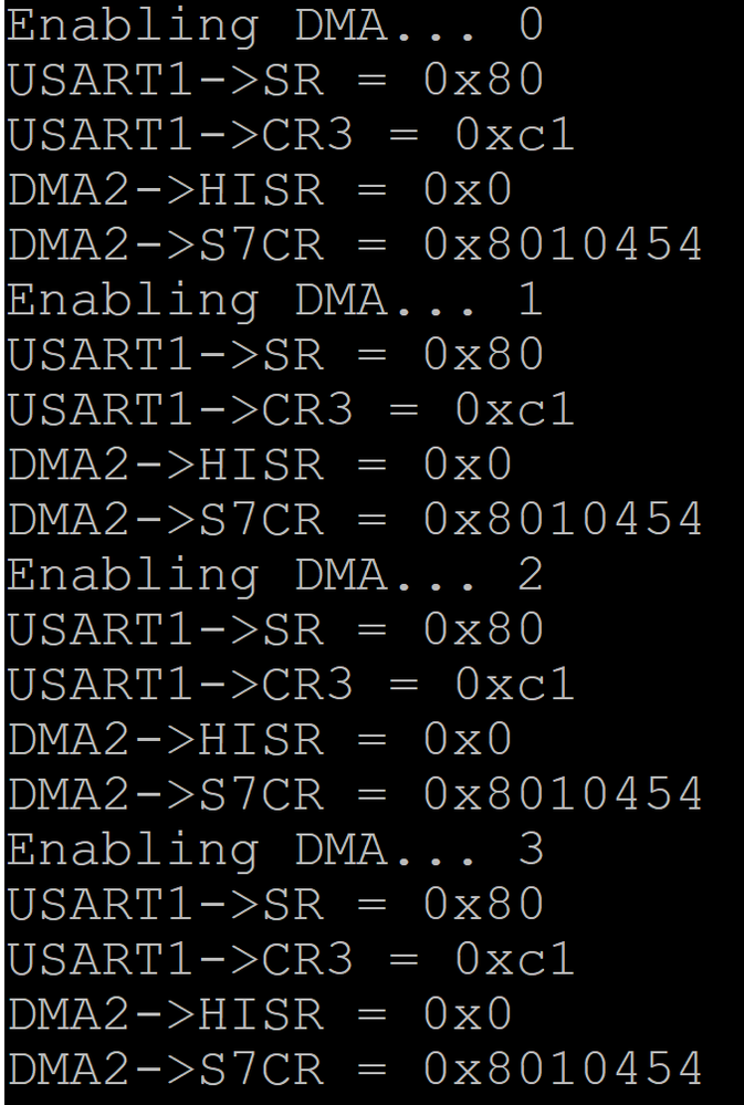

The DMA registers, when the problem happens, read like this:
Sorry that the information I have doesn't directly solve the problem. But if anyone else has the same problem this could be helpful to them.
