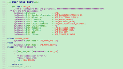

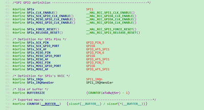

Because there is no example code in the STM32F401RE-Nucleo folder, so I ported the code from STM32F411E-Discovery SPI example code, the original code was configed on the SPI2, but the STM32F401RE-Nucleo only provide the SPI1 on the socket to use. so I changed the SPI2 to SPI1. RichKnight_2-1711392463499.png
This is my SPI1 Configuration.

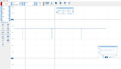

As my uderstand, the clock signal from full duplex SPI master should be continue signal, instead of the clock only enabled during the Master want to sending the message. But when I tried to capture the clock from oscilloscope, I got below image (the clock seems enabled only the master tried to send and receive message).
I set the message to be sent every 500 ms.

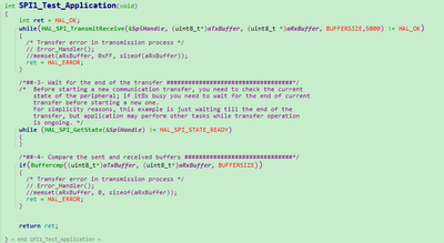

This is my test code (I only use the polling method on the SPI test).
from the test result, If I set the slave and master message sending cycle time are same (for example every 500ms), the master may receive the wrong message, only if the slave cycle time less than master (for example, slave send every 100ms, and master send every 500ms), the message from slave will be right 100%.
That is not correct.  The SCLK only toggles when the master has data to send (for full duplex SPI).
Since you are using the "polled" version of the SPI calls (HAL_SPI_TransmitReceive()) you don't need a separate check for "transaction complete" - it will by definition be complete when HAL_SPI_TransmitReceive() returns.
The slave cannot send until the master initiates the transfer.  The slave should not have a timer on when it tries to send data to the master.  It should simply call the transmit/receive function and wait for it to complete.  Process the incoming data, prepare the next buffer to send and then call the transmit/receive function.
NO.
SPI (master) sending...some clks..end. IF send+receive, you also receive something. Thats it.
If you not "send" , nothing happens.
