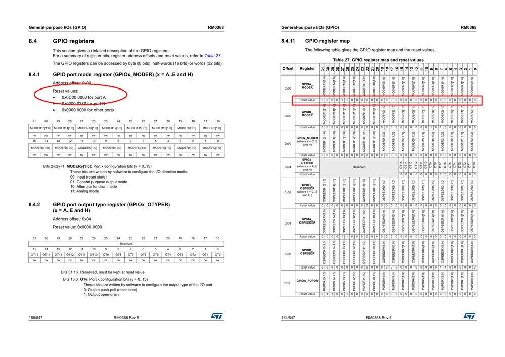

STM32F401/RM0368 bad GPIOA->MODER reset value
waclawek.jan
As reported here, this is obviously incorrect.
0693W00000QN7YeQAL.pngAlso, this has been already reported by Uwe Bonnes for 'F411/RM0383, which has indeed been corrected in the registers description, but the GPIO register map still contains the incorrect value. So, could ST please go through all low-end 'F4 RM and check/correct at both places where applicable?

Hi @Community member​ ,
Thank you for bringing this issue to our attention.
I confirm this issue in RM0368, RM0383, RM0401, RM0402 and RM0430.
The correct reset value of GPIOA_MODER register is 0xA800 0000.
I reported this issue internally.
Internal ticket number: 133879 (This is an internal tracking number and is not accessible or usable by customers).
Kaouthar

Hello @waclawek.jan ;
The issue is fixed in RM0368 Rev 6RM0383 Rev 4RM0401 Rev 4RM0402 Rev 7 and RM0430 Rev 9.
Thank you.
