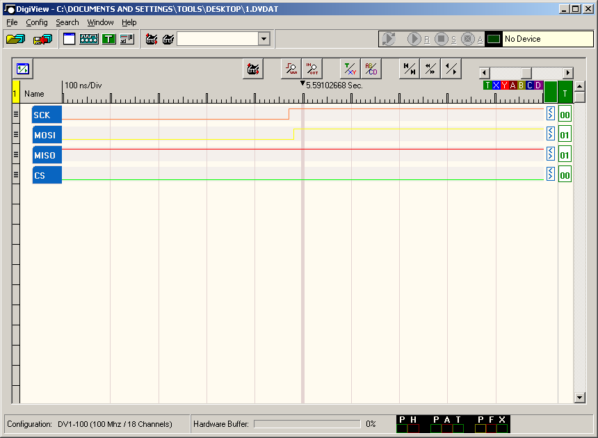

I am using SPI1 with HAL low level drivers, STM32CubeF4.
I have used the following SPI configuration:-
SPI_HandleTypeDef hspi;
hspi.Instance=SPI1;
hspi.Init.Mode=SPI_MODE_MASTER;
hspi.Init.Direction=SPI_DIRECTION_2LINES;
hspi.Init.DataSize=SPI_DATASIZE_8BIT;
hspi.Init.CLKPolarity=SPI_POLARITY_HIGH;
hspi.Init.CLKPhase=SPI_PHASE_1EDGE;
hspi.Init.NSS=SPI_NSS_SOFT;
hspi.Init.BaudRatePrescaler=SPI_BAUDRATEPRESCALER_256;
hspi.Init.FirstBit=SPI_FIRSTBIT_MSB;
hspi.Init.TIMode=SPI_TIMODE_ENABLED;
hspi.Init.CRCCalculation=SPI_CRCCALCULATION_DISABLED;
hspi.Init.CRCPolynomial=0;
HAL_SPI_Init(&hspi);
After sending some bytes on MOSI. On logic analyzer, I see clock and MOSI data are mismatched.
This is a very zoomed in pic, If required I can send the whole logic analyzer file.
If any more code is required, let me know I'll send it.
For read and write, I am using
HAL_spi_transmit(&hspi, Byte, 1, 5);
HAL_spi_Receive(&hspi, Byte, 1, 5);
I did the almost same spi configuration with stm32l151rct6a, using std periph library and it is working.
Question: Why is the clock not synchronised with MOSI.

Hi singh.ishmeet,
Can you provide the HAL_SPI_MspInit() API and the snapshot of the first SPI transmitted byte ?  That would help more easily figure out where a problem could be.
In fact, what we see on  the logic analyzer is just the SPI GPIO configuration, and not “the clock not synchronized with MOSIâ€�, this is just the SLK I/O already configured before the MOSI I/O (the clock for data is not yet generated on SLK I/O).
