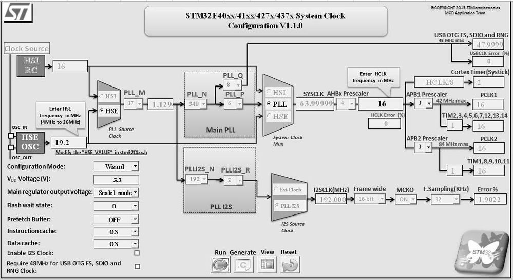

Thanks for the reply. I used the ST excel clock configuration tool and got PLL M = 17, N=340, APB1 prescaler  = 1, APB2 prescaler =1.
Having setup a UART1 to run at 57600 bps I get a UART rate of ~139kHz on the scope. 2.4 times higher than what it should be. Is there something in the UART librar itself I need to change....? Does it matter what the APB2 clock result is, the UART library adjusts the baud rate based on its setting?

The part is not rated to run at 192 MHz!?
For the baud rate it suggests the define for HSE_VALUE is wrong, ie 8000000 and not 19200000

How did the 192MHz number come up?
I've included a screen shot of the clock config tool.
Shouldn't the HSE_VALUE match the actual oscillator frequency or you are saying that the UART library only expects a 8MHz external OSC?
