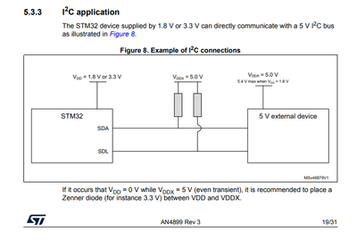

It's possible to setup the configuration described and speaking about 5V tolerant pins only in input mode.
When the output mode is enabled, the GPIO is no more 5V tolerant.
It could work based on next principle for I2C. Taking into consideration that problematic could be difference between VDD and VDDx, which should never exceed 3.6 V:
Thanks

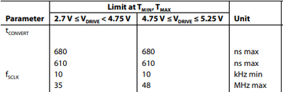

Because this ADC can use a higher SPI frequency with a Vdrive of 5V, I want to try if it's possible to reduce processing time.

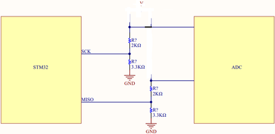

Only for inputs (here) can use a voltage divider, like 2k - 3k3 -gnd. So input at 3v3 max.

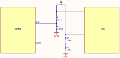

The voltage divider is like this?:
>The voltage divider is like this?:   yes, but without the short to 5V . :)
But need lower impedance resistors, at 2k /3k3 it might work up to 10MHz - but never 50MHz.

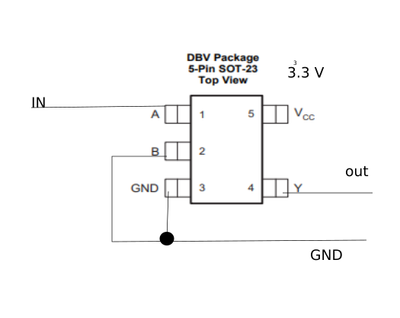

as level shifter gates i use something like this :
SN74LVC1G86   (single XOR gate ; at mouser 20ct , 595-SN74LVC1G86DCKR )
so need one for every line :
At 50MHz this is the way to go ; LVC gate can switch in 1.3ns at 3v3 (50pF load), so perfect here.
Open drain and about 50 Mhz is probably no good combination, either current hungry  or with bad waveforms.
