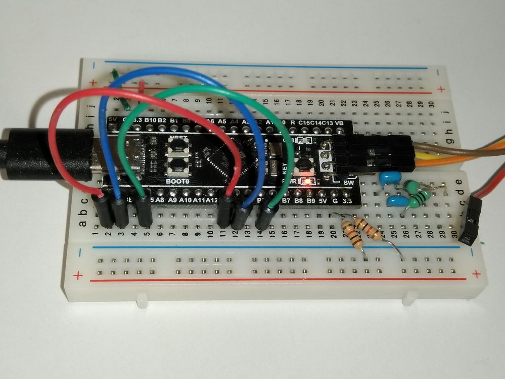

I wrote I2S Loop back test program. I2S2 as Master Transfer mode and I2S3 as Slave Receive mode. (Proto for ADC in and DAC out.)
It works OK when 16bit in 16bit frame. However, in 24 bit in 32bit frame, DMA pointer etc. are corrupted.
With step-by-step trace, I found crushing point in stmf4xx_hal_i2s.c.
Is this BUG or my program is wrong???
Many thanks in advance,
K.A.
Gist of the program is below and screen shot of IDE is attached.

‎2020-09-25 12:42 AM
> However, all received data was 0xFFFF.
Observe the data using oscilloscope/LA. Check for bad solder joints.
‎2020-09-25 8:14 PM
Dear Jan,
Thank you very much for your reply. Your comment is very encouraging.:smiling_face_with_smiling_eyes:
Unfortunately, I do not have Oscillo or Logic analyzer. But my test bed is very simple.
Therefore, I need check the received data.
In 16bit in 16bit data frame case, I thought loopback data (received data) is OK, but it was NOT.
Received data is unexpectedly SHIFTED. (see red part) [PDF attached]
And In 24bit in 32bit data frame, received data was DISASTROUS!!!
If you (and anyone!) have any idea what is wrong, please enlighten me.
Many many thanks in advance.
K.A.
‎2020-09-25 9:10 PM
One Correction.
I checked Device configuration again, and found an error in 24bit mode. (Assignment of SCK for I2S3 was not correct.)
However, received data was same as 16bit mode, that is, received data was SHIFTED. [please see PDF]
Please help!!!
