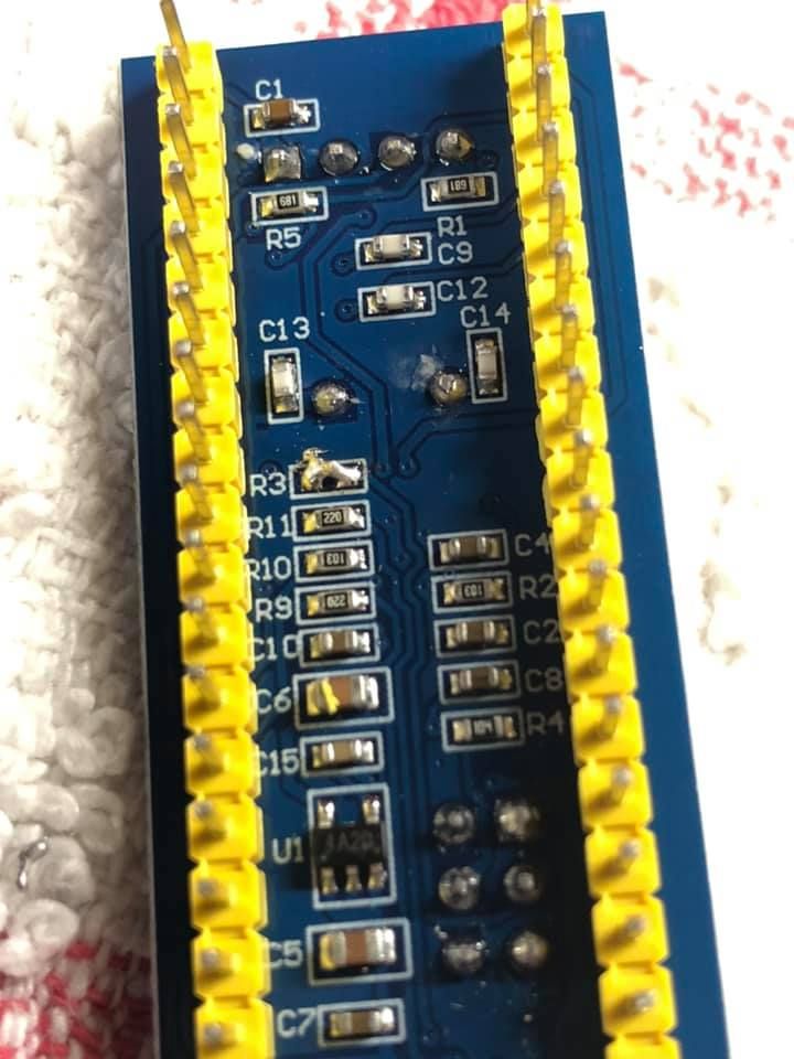

0690X00000BvsseQAB.jpgSolution: I had this problem. R3, listed as 100k. Has 104 printed on it. It was suggested to remove this resistor and replace it with a jumper/short. This worked on my boards. I have 6 boards with this issue. R3 is hooked in series between the MCU and the boot0 header pins. You can see the schematics half way down this page... freeelectron.ro/bare-metal-stm32-led-blink

Same problem here. I weldered a short in R3 but problem persists. Only blinking led even changing the jumper.
May be a problem in boot0 software?
