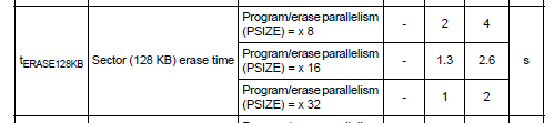

Worst case stall on a 128 KB sector is of the order of 2-4 SECONDS as I recall. And up to 32 for a Mass Erase, but clearly you can't be running code in a single bank in such situations.

Ah, I was looking in the wrong place for those tables. (Tables 39-40 in device datasheet Rev4).
