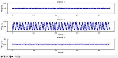

I have a problem and currently no clue how to further debug. Maybe one coudl help me.
I use STM32f4 to capture with ADC1 3 signals with 1Mhz (so 333kHz per channel) triggered by a timer and transfered via DMA. I have a DMA buffer of 3*2*100 (so 100 samples per channel per half DMA). When DMA is Half/Full filed, I store the data in a second buffer with 10 times 100 samples. Using a test sin signal ~23kHz, I get discontinuities at each 100 sample border.
I check the code several times but could not find an error and it seams like ADC sampling is kind of pausing at each DMA Half/Full callback call (which seams not plausible)
BR, BastelBaus
The faulty output with discontinuities each 100 samples:

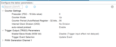

Timer configuration (96Mhz clock)

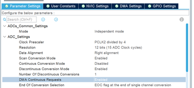

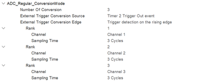

ADC configuration

I found my bug, I was clearing "new_data" when checking for buffer_overrun .... very *** ...
Sorry for any inconvinience !
