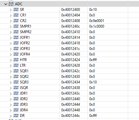

I´m working on a Project with a STM32F373CCT. I need to compensate the signal read from the SDADC Signal with the internal ADC Temprature sensor.
The Problem is that I only get the Value 0xFFF from the internal Temprature Sensor and also the Reference Voltage Channel.
I already checked the ADC configuration Bit ADC_CR2_TSVREFE. It is set and it is set before the ADC is turned on.
I also checked the VDDA and VSSA Pins with a DVM. They are connected to the GND, 3.3V VCC accordingly.
Also the ADC is running at 10MHz and a sampling Time of 239.5 cycles should be far greater than the needed 17.1µs sampling Time for the Internal Temperature sensor.
Some more Information to the Project:
I am using the SDADC with the internal 1,8V reference, but this reference should be seperated from the normal ADC Voltage.
I am using the current STMCubeIDE 1.5.0 with STM32Cube MCU Package for STM32F3 in Version 1.11.2

As mentioned above, changing the Channel to the internal ADC Ref measurement doesn´t change the measurement result. It always measures 0xFFF.
Can somebody help me, or have some clues, what to check next to use the internal Temprature sensor?

For anybody who has a similar Problem with the Internal ADC Temprature or Ref Voltage Measurement.
There has been a Pin with a Voltage greater than VCC or less than VSS. (2 Inputs connected without a proper Voltage Level.)
According to the support this can happen when Voltage on any possible ADC Pin (even if the Pin is not set for the alternate Function) is present.
Setting all Unused Pins to Input and activating the Pull-Down resistors (for defined voltage levels on all Pins) fixxed the Problem.

Additional Info:
I added the 100ms Delays just to be sure there are no sattling Time Issues of the ADC. I know they are useless otherwise.
And from on Target Debugging: This is what the ADC Registers look like after 2 Cycles of ADC Measurement.0693W000006EqcOQAS.png
