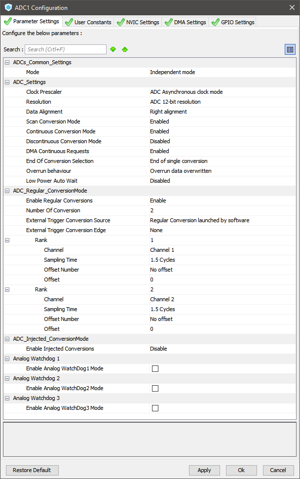

In my project, I use the ADC configured in scan mode, as seen on this screenshot from STM32CubeMX:

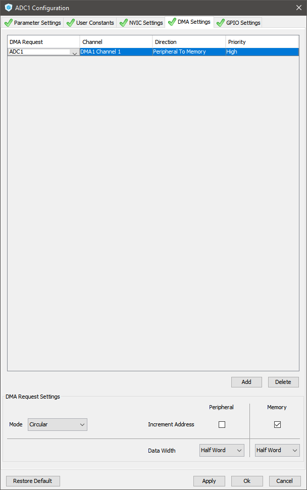

and the DMA configured as follows:
The problem is that I can't get any data transferred from ADC to memory, when I call
volatile uint32_t ADC1ConvertedValues[2];
HAL_ADC_Start_DMA(&hadc1, (uint32_t*)ADC1ConvertedValues, 2);
When I open the peripheral view on Keil uVision I can see that the ADC is working properly and the conversions are happening.
Can you tell me where's the problem?

Wouldn't the samples be uint16_t ? (HALF WORD)
Is the DMA peripheral indicating an error?
