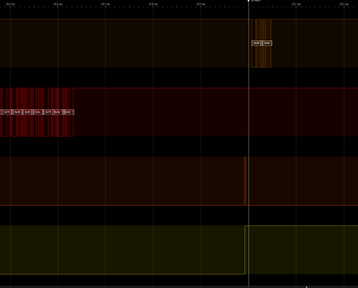

Under situations of high load (both reception and transmission) UART1 will stop outputting messages after two bytes. The majority of transmissions work out fine, however the error happens in every test case, though the time to failure differes between approximately 5s and 120s. The problem seems to be caused by an unintended reset of the DMA enable transmitter (DMAT) Bit in UART 1 control register 3 (USART_CR3).
Above image shows the error:
Trace 1 (orange) shows the TX line of UART1, where only two bytes are transmitted.
Trace 2 (red) shows data on RX line. One can see that no RX takes place at the same time as TX.
Trace 3 shows a debug pin, it is triggered once when DMA transfer is started.
Trace 4 shows another debug pin. It is set HIGH when DMA transfer is started and is set LOW in DMA Transfer finished interrupt triggers (which never happens, because DMA never finishes its transfer, because UART stops emitting data).

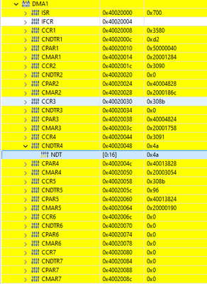

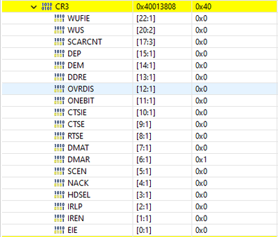

A look at the peripheral registers shows the following:
UART 1 CR3 shows that DMAT is off. It was not set to off by software anywhere!

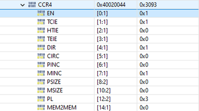

DMA1 Channel 4 Configuration register shows that DMA channel is enabled.
DMA1 Channel 4 count down register shows that there are still 74 (0x4a) bytes remaining to be transmitted.

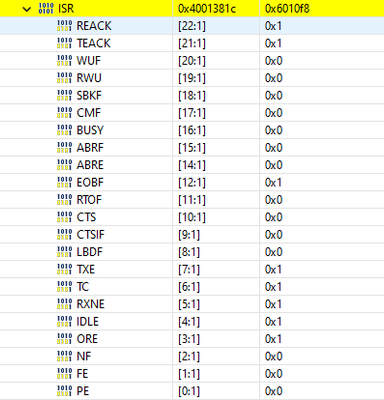

Check USART ISR registers for error codes. Probably a frame error or other noise error is occurring. You need to deal with it before the peripheral will start working again.
makas005
makas005Author
December 13, 2024
USART 1 interrupt and status register:
Overrun error (ORE) Flag is active, however this should only flag received data and should definitely not disable DMA for the transmit stage.

December 13, 2024
If DMAT=0 it's not going to be sending anything out with DMA.
Set a hardware watchpoint to figure out what is modifying this memory. Probably it's in your code somewhere.
While ORE may not be the direct issue with transmission, it certainly indicates there is an issue with the code. Characters are being sent while the peripheral is not being read out quickly enough. Solving that may solve the other problem.
makas005
makas005Author
December 17, 2024
Using a hardware watchpoint on the register is not possible to my knowledge, because a storage position in the peripheral, not in RAM, has to be watched. Additionally, DMAT is set and reset for every outgoing transmission. Since the error case is not directly reproducable (only by letting the UART run under high load for some time), I don't see a way to make sure the watchpoint triggers on the wanted event.
Further tests have shown that the ORE bit is not set every time the error occurs. Since the UART is embedded into a bigger project, overruns can occur and are acceptable. An RTOS schedules the whole program, and the handling of incoming UART transmissions has a rather low priority.
waclawek.jan
November 18, 2025
I know this is an almost one year old thread which resurfaced only because of what is probably AI generated nonsense (maybe as part of attempt to inject a spamming link). However, here IMO the issue is software inadvertently clearing DMAT, as @TDK said above. This won't be at an expected place, i.e. wherever DMAT really gets cleared, but anywhere else where USARTx_CR3 gets written. I'd bet that write is non-atomic, which together with interrupt-based program (and RTOS is nothing but threads interrupting each other through the OS's timer) may easily lead to such "bit loss".
Btw., data breakpoints (a.k.a. watchpoints) *can* be placed at peripheral addresses, although as any other debugging tool, it's not a panacea, expecially if there are many intended writes to that peripheral, as is the case here.
Also, in 'F3 (i.e. CM4), APB peripherals are in the bit-band-able area, which may be a way to write bits in the peripherals' registers in a way which is atomic from the interrupts/software perspective.
