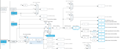

This is my system clock configuration:

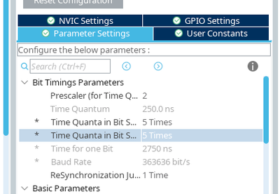

And these are the CAN settings:
They are different from yours.

I have two questions:
  • Are you sure, your CAN bus bitrate is 363636b/s?? it's not common bitrate for the CAN protocol. If you're in loopback mode is OK but you have an already established CAN bus. So, could you please check what is your real CAN bus bitrate?
  • Why you're not using the maximum CPU speed 72MHz?

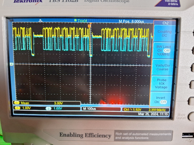

I took a picture of the scope:
About the system clock, there is no important reason to be running at low speed. I came from AVR and just did not want to hit hard the accelerator. Increasing to full speed is in the future plans. Should I run it at full clock?

I suggest the following system clock config if you don't have any power consumption constraints:
You configured the HSE in bypass mode. Is it intentional? Do you have an external crystal? or Crystal generator? you need to check.
But you didn't answer to my question yet regarding the strange CAN bitrate of 363636b/s. That's important!
I would not recommend neither CPU at 8MHz and APB at 8MHz. Need to have some divider between the two for optimum operations. Low clock CAN frequencies decreases the sampling performance of the bit time.
I have an external 16MHz crystal. Maybe that is why the HSE bypass is configured. I sincerely cannot answer your question with certainty.
About the bitrate, how can I measure the real one? I thought the oscilloscope image would give some hint on that. With auto retransmission enabled, the scope shows a CAN frame with a payload of 8 bytes taking about 400us of the bus time. That gives me 2500 frames/s of  8 bytes each, or 160 000 bits/s. But I bet this is not the way the bitrate is measured. But by looking inside the frame, each bit seems to be using around 3 us of bus time, or around 333kbits/s. All these values are approximate as were measured on screen.

You need to get your CAN bus bitrate otherwise it couldn’t work. CAN bit time is strict it shouldn’t be calculated approximately, when it’s 500kb/s it should be 500kb/s no more nor less.

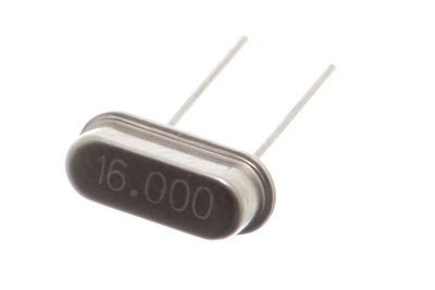

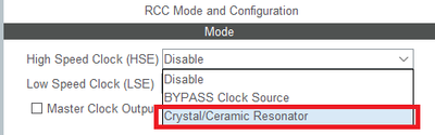

If you are using this kind of crystal (through hole):
You need to configure HSE as following:

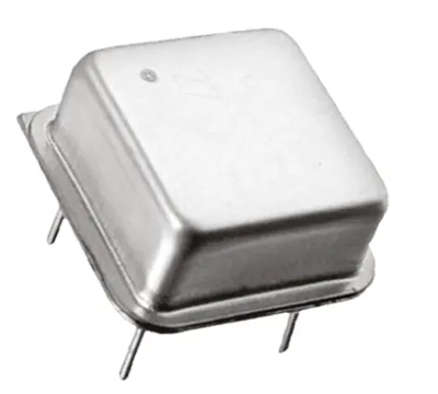

If you are using this one (through hole), you can keep it in bypass mode.
