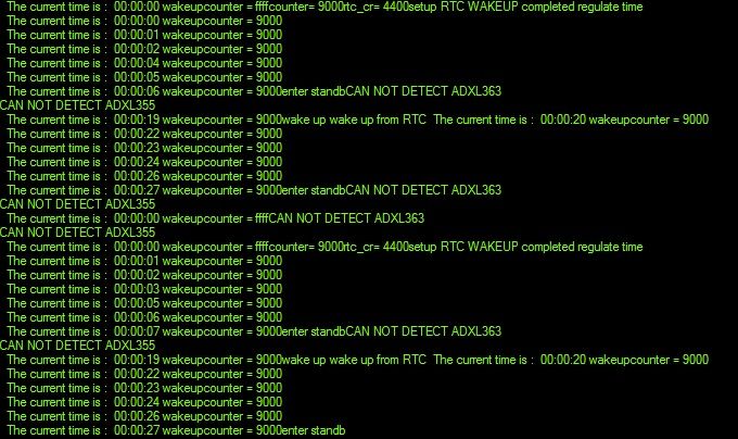

0693W000000TpfXQAS.jpgHi
I am using STM32F205RCT6 to try periodical wakeup from standby mode. I choose RTC_WakeUpClock_RTCCLK_Div16 and set wakup counter 0x9000, that is about 18 Seconds @32768hz LSE. In main function,first print wakeup counter and RTC_CR, then every 1 sec print the wakeup counter and realtime . I found that: 1. the RTC_CR looks correct, 0x4400 means WUTE is set and WUTIE is set as well 2. the wakeup counter did not counter down, 3. the MCU can wakeup only once from standby mode on time.
Here is code:

RTC wakeup interrupt IRQ clear the flag, not sure why just wake up once.
