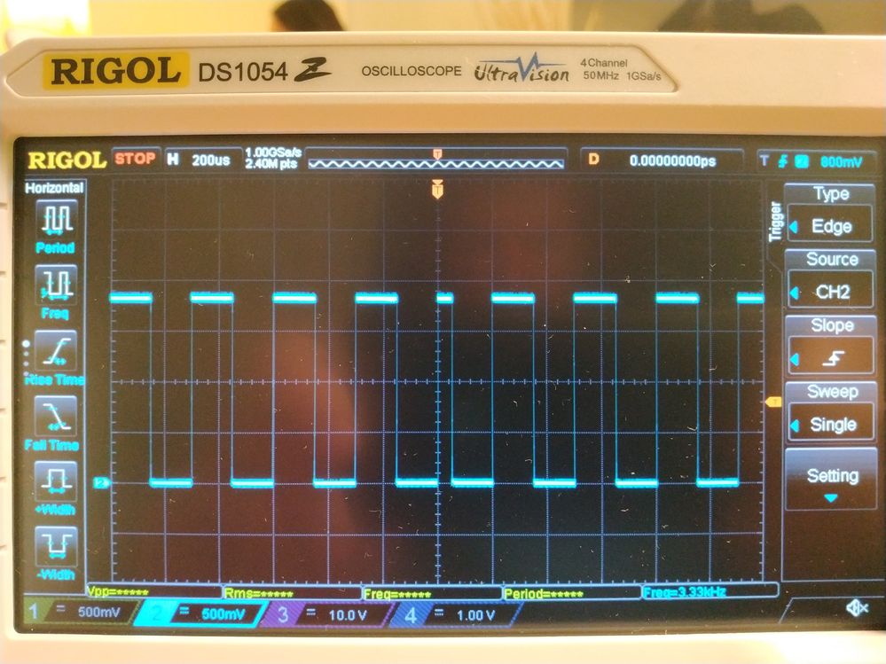

while (1)
GPIOA->BSRR = 0x0040; // PA6
Delay_us(100);
GPIOA->BRR = 0x0040; // PA6
Delay_us(100);
} //while(1)
Hello ST after a lot programming with STM32F103 I startet with the STM32F030 and the STDPERIPH-Lib. Just an "easy example" of using a timer delay to blink an GPIO-Output.
I noticed a strange behaviour on the oscilloscope: Sometimes the timing of the delay switches to a very small delay. First I thougt of som integer overflow effects but when I switched to 32Bit delay function the strange jitter still exists.
After initializing STM32 with 48MHZ only GPIO and TIMER 14 is initialized. I thougt of a watchdog function but this is als disabled . What on earth hits this wrong timing in between the 100us delays???
//##### TIMER 14 Init ########
void TIMER14_Init(void)
TIM14->PSC = (uint16_t) 0x47 ; // Prescale 48.000.000 / 48 = 1MHz // Prescale 48
TIM14->ARR = (uint16_t)0xFFFF; //Autoreload 0xFFFF
TIM14->CR1 |= 0x0001; // Timer enable
void Delay_us(uint16_t us) // microseconds
volatile uint32_t start = 65536; // offset for not running in negative integer
start += TIM14->CNT; // read Counter register
while( ( (TIM14->CNT + 65536 ) - start) < us ); // compare old with new
Picture: smaller delay at the timeline center
thanks in advance for your help.
Henry

‎2020-03-08 11:27 AM
Offcourse the timer prescaler is 47 dec and not 0x47 hex for a 1 usecond timer clock. But this doesnt change the jitter problem .
Regards Henry

‎2020-03-08 3:08 PM
The overflow of the counter is causing the problem. Your offset to avoid negative numbers is not doing what you think it is doing.
uint32_t start = TIM14->CNT;
while ((TIM14->CNT - start) % 65536U < us);
Note that since CNT is volatile, you don't need to declare start as volatile as well.
Edit: changed the code. Pretty sure this will work, did not test it though.
‎2020-03-08 3:42 PM
Hello TDK,
thanks a lot. This works without jitter.!!. Well done !!!
There are so many examples in the web, which do not consider timer overflow. I wonder how any of these softwares run strable. Of course most of the time the delay works but the wrong delays inbetween can cause a lot of trouble when needed for pulse shaping or simple display control software.
Regards Henry
