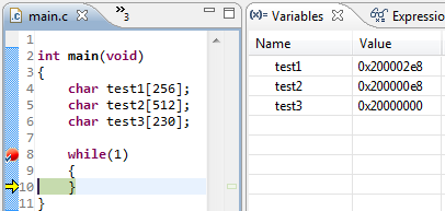

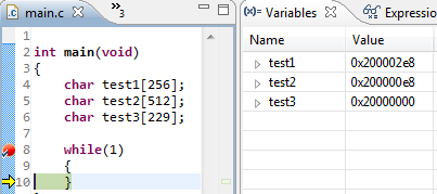

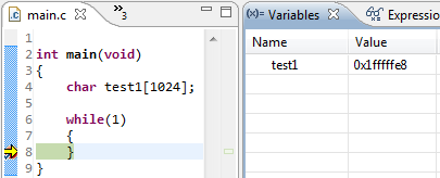

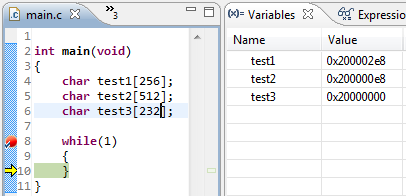

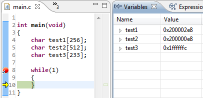

Posted on March 14, 2014 at 16:02
1.  Everything normal
2. Already strange behaviour. Stack size doesn't increase although test3 is one Byte larger
3. Same here, stack doesnt grow
4. Stack is corrupted (with test 3 being 232 Bytes large)
5. Stack is corrupted with large arrays
I'm on a STM32F103RB - so I should have 20kBytes of RAM. Can anybody explain what's happening here and how I'm able to fix that?

Based on your addresses the stack is pitifully small for the allocations you are making.
Make the stack bigger, perhaps in your linker script or startup file, you don't mention a tool chain, and I'm not going to guess.

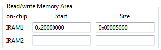

Thanks for the reply!
I'm on CooCox CoIDE v.1.7.6 with arm-none-eabi-gcc 4.8 2013q4.
The linker setup seems correct to me though:
0x5000 = 20480 - so this matches exactly the promised 20kB from the datasheet! What am I missing? :)
Posted on March 14, 2014 at 16:37
You are describing the size of the RAM, not the SIZE and PLACEMENT of the STACK within that space.
In Keil we define the stack within startup_stm32f1xx_xx.s, where you'd do it the the CooCox GUI I don't know. For GNU/GCC it is often defined in the linker script, points to the top of memory and moves down to the heap. You appear to be defining a stack in the 512 byte range, and it's placed very low in RAM.
If CooCox doesn't have documentation, or you can't find it in your GUI, try their forum.
