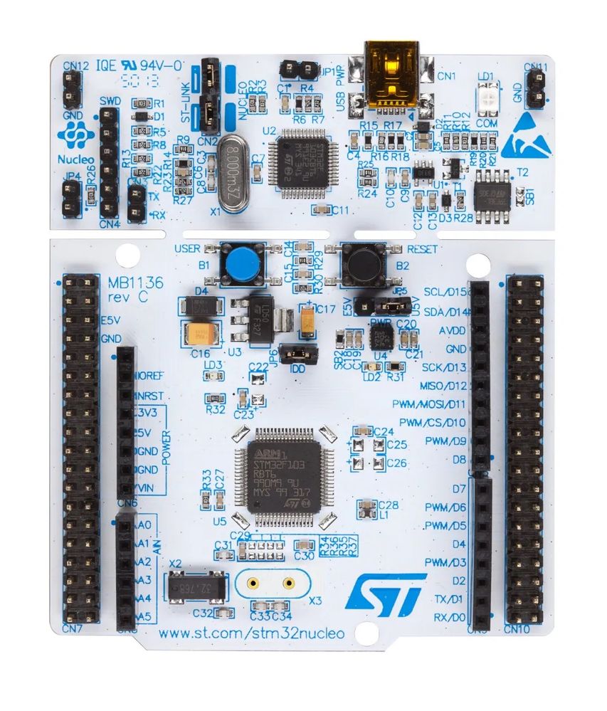

I have a stm32 nucleo-64 stm32f103 and i tried to use the swd port to connect to the target board via pin 1-6 and could not, is this the correct board do i need another one?

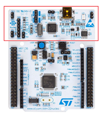

For the NUCLEO to connect to an external target you must pull the jumpers to disconnect the local target.

what pins do i remove to make it read external target?
‎2024-09-07 8:43 AM
Did you de-attach this part?
If not, connect a USB cable on CN1 and use CubeProgrammer to connect to the MCU.
