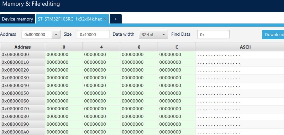

in the process of or at least i want to backup the mcu data and transfer it over to another mcu,  i can connect and see the mcu with my pe cyclone fx but when i read and dump the data i get a empty file 768kb.
S3150800000000000000000000000000000000000000E2
S3150800001000000000000000000000000000000000D2
S3150800002000000000000000000000000000000000C2
S3150800003000000000000000000000000000000000B2
S3150800004000000000000000000000000000000000A2
S315080000500000000000000000000000000000000092
S315080000600000000000000000000000000000000082
S315080000700000000000000000000000000000000072
S315080000800000000000000000000000000000000062
S315080000900000000000000000000000000000000052
S315080000A00000000000000000000000000000000042
S315080000B00000000000000000000000000000000032
S315080000C00000000000000000000000000000000022
S315080000D00000000000000000000000000000000012
S315080000E00000000000000000000000000000000002

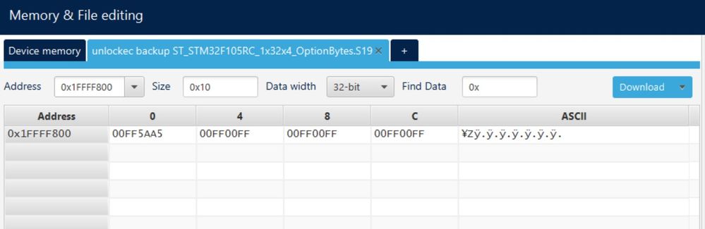

this is the data i pulled from it with my pe cyclone fx would love to just read it with the stlink but if i dont unlock the option bytes before the dump i get all 00 if i unlock it and read it this is what i got.
no i have not removed it, I thought I got a bad st link and did not want to damage it further, this is the data i got from the full dump a bunch of nothing..nothing data.jpg

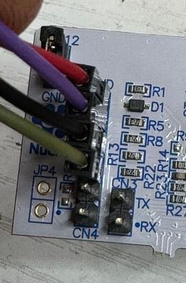

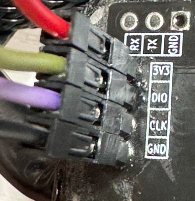

Disconnect both jumpers on CN2. Connect GND/SWDIO/SWCLK between CN4 and your target board. Ensure target board has power. Optionally, also connect VCC and NRST. See nucleo user manual for CN4 pinout.
  • Pin 1: Target VCC
  • Pin 2: SWCLK
  • Pin 3: GND
  • Pin 4: SWDIO
  • Pin 5: NRST
  • Pin 6: SWO
After that connect with STM32CubeProgrammer and observe flash data.
brt2015
so i have both options to power the mcu via the st-link completely via pins 1-6 or externally using the pins for data
You cannot power the board with pin 1 of CN4. It is an input to the st-link.
You must power the board some other way.

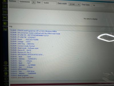

 Wired it up as suggested I think it’s locked , I try a virgin mcu and I can connect and no errors .IMG_6054.jpeg
Guru
Voltage: 0.01 V suggests it isn't powered, or that you don't have power hooked up. It looks hooked up in your pictures.
Is RDP set? Check option bytes in OB tab on left.

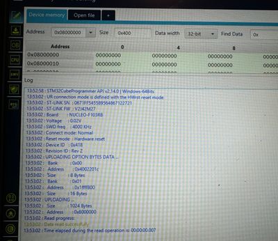

This is the target board the one that new unlocks
  I went ahead and activated the RDP on this teta board just to see and am getting the same message from the other one so am to assume I just locked the test board , how do I unlock it again ??
Go to option bytes and change RDP to level 0.
brt2015
did that minutes after the last post and it erased the entire chip and i gained access again on the test board , if i do this it will also mass erase the mcu i wanted to read initially, i guess they locked it and want no one looking inside.
