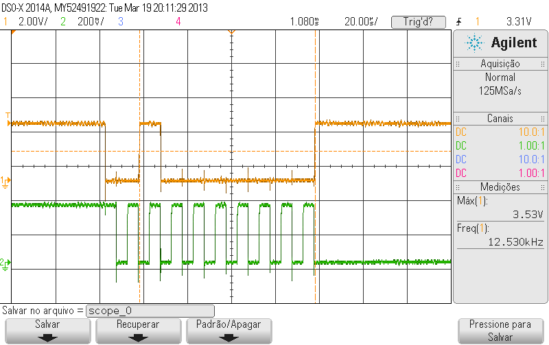

I am trying to comunicate with MCP23016 by i2c and i am using STM32F103RB with uVision 4.
The problem is that if I send 0x40 is the same if I send 0x41. Its the red mark on the code.
My code is:

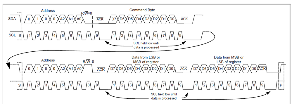

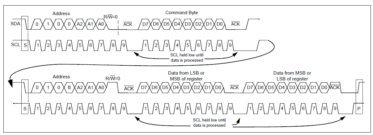

Thats what mcp23016 needs.
And here the screen shot of 0x40:

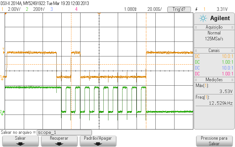

And here the screen shot of 0x41: (nothing changes)
I also tried another number like 0x48 and 0x49 and its the same too. I dont know what to do.

    You might also observe the use of I2C_Send7bitAddress(), the low order bit determines the direction, the address you want for the I2C device is in the high order 7-bits. So shift your address left by one if appropriate.

    If you decide to use the ''library'' (which in my personal opinion is a completely useless intermediary ''layer''), you are bound to read the documentation available for it. And, if everything fails, simply read the source.
    void I2C_Send7bitAddress(I2C_TypeDef* I2Cx, uint8_t Address, uint8_t I2C_Direction)
      /* Check the parameters */
      assert_param(IS_I2C_ALL_PERIPH(I2Cx));
      assert_param(IS_I2C_DIRECTION(I2C_Direction));
      /* Test on the direction to set/reset the read/write bit */
      if (I2C_Direction != I2C_Direction_Transmitter)
        /* Set the address bit0 for read */
        Address |= I2C_OAR1_ADD0;
      else
        /* Reset the address bit0 for write */
        Address &= (uint8_t)~((uint8_t)I2C_OAR1_ADD0);
      /* Send the address */
      I2Cx->DR = Address;
    I believe it's now clear enough.

    Thank you all for the tips. I get it working. I had some more problems with the  I2C_GenerateSTART and    I2C_GenerateSTOP so I use the registers and  now its fine.
