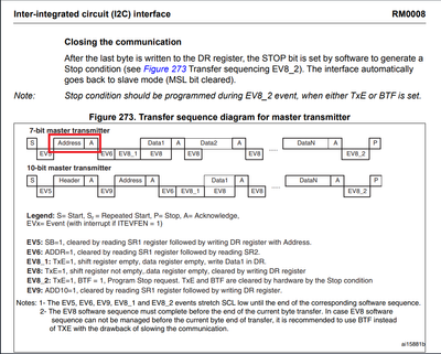

7-bit master transmitter (see Figure 273).

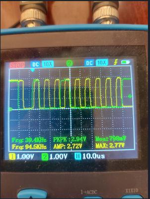

When I send Address then I receive AF bit of I2C_SR1 register equals "1" (Acknowledge failure). But the diagram taken from the oscilloscope shows that after the address there is a Acknowledge bit equal to "0". Which does not correspond to the AF bit in I2C_SR1 register. Why? I also attach the program code.

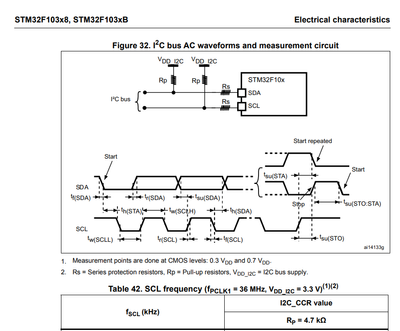

I was solving this problem. There is the Figure 32 (I2C bus AC waveforms and measurement circuit) in the STM32F103RB datasheeet (see Figure 1 in this text). STM indicate that Rp resistor must be equal to 4.7k, but not indicate resistance of Rs. I have put Rp equal to 4.7k that is right. Also, I have put Rs equal to 4.7k that is wrong. Rs must be equal to 100 Ohm. Because the Rs value was not correct, I2C periphery of STM32F103RB did'n work properly.
As a result, Rp must be equal to 4.7k and Rs equal to 100 Ohm and not Rs equal to 4,7k.

waclawek.jan
How do you know?
Show.
I'm looking through the debugger.
This loop constantly returns 0x00 (see above is the full code).
