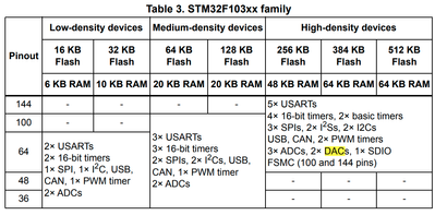

I  had started an STM32F103C8T6 project in STM32CubeIDE. Now I wanted to use a DAC to output an analog signal from an internally stored wavetable.
I don't see any DAC when opening the IOC editor. Doesn't the F103 have any DACs?

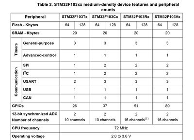

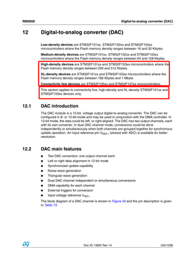

Only high-density STM32F103 devices have a DAC.  The STM32F103x8 is medium-density.

take a look at the ds --- might help.

Thanks. So I will have to sort out to PWM in this case. Changing the horse is not an option momentarily.
