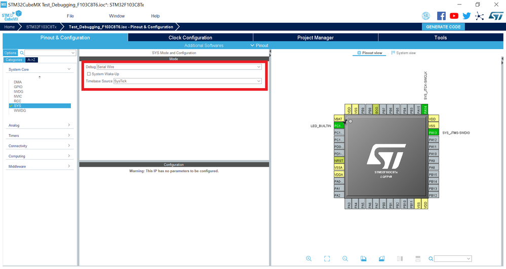

  • Here's the CubeMX configuration:

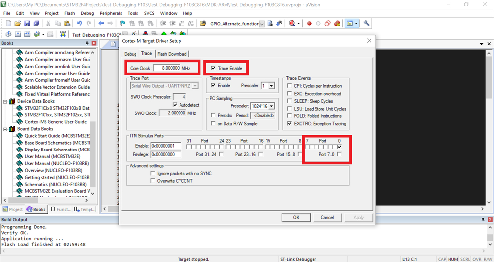

  • The Keil µVison configuration:

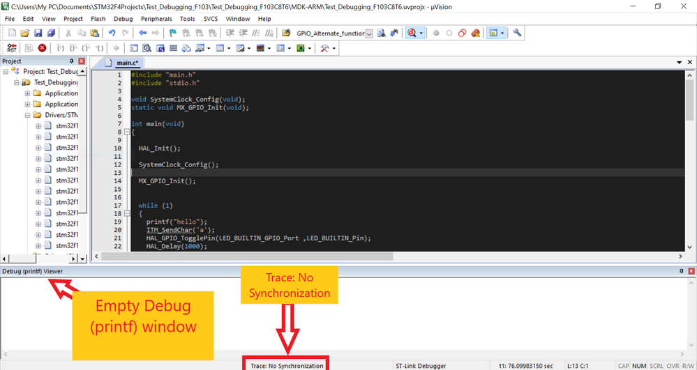

But it's not working when I start the debugger and I open the printf window it's empty and and I noticed a message below on Keil µVision "Trace: No Synchronization"

This should work, if not make sure you use the correct "core clock" in the MDK-arm options.

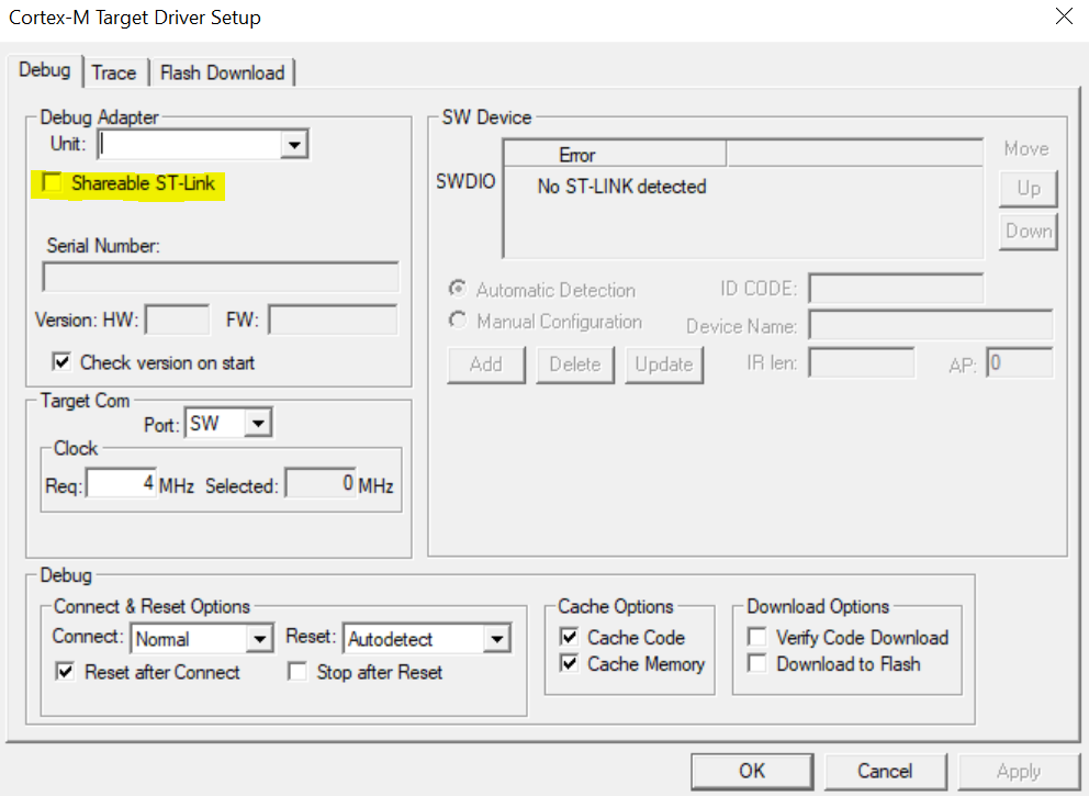

PS: The SWV is not supported when using ST-LINK Shared mode, so make sure it is not checked as in the photo I attached.

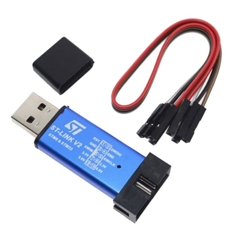

I tried what you advised me, but it also doesn't work, However I tried with a stm32 discovery board with an integrated ST-LINK and it worked, I deduce that the ST-LINK that I used is a cheap Chinese one (on the photo above) is not compatible with the TRACE.
