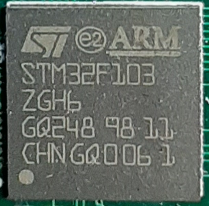

STM32F103ZGH6. The chips came from Arrow, though I'm looking at that date code and it looks like the 1st week of 06. Yikes. They were supplied to me in a tray from the company who I contract for and they bought them from Arrow.

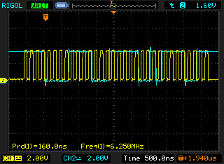

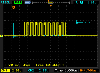

I have a CPLD that has the SPI master on board. After I load up the buffer and call the TxferSPIBuff, I pull a GPIO low on the STM which tells the CPLD to start the transfer. It shifts some header bytes out on the LVDS (obv my transmission medium) and then when the CPLD needs the bytes from the STM it pulls NSS low and starts the clock.
The first image is the clock with yellow trace and the NSS with blue trace. I did have an issue with NSS when I was bringing it low (from the FPGA) too fast and I was sometimes missing the first bit. I extended the time from NSS going low to the first clock to a full byte and also after the last clock so those timings are good (according to the datasheet). The NSS timing is exacly the same for both 8bit and 16bit modes shown next.

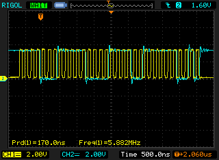

The third image is 16bit mode with both PSIZE and MSIZE set to 1 and the DFF bit in the SPI CR1 also set to 1. I'm setting the transmission length to 2 in this case so I get my 4 bytes. The buffer contains 0xF0, 0xF1, 0xF2, 0xF3 so you can see I'm getting those in little endian format as expected.

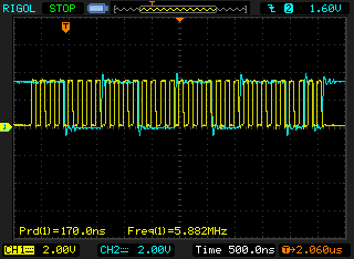

The fourth image is both PSIZE and MSIZE set to 0 and also DFF set to 0. The transmit buffer again is 0xF0, 0xF1, 0xF2, 0xF3. I'm setting the data tranmission size to 4 bytes for this one.
I've had it up on the debugger all morning playing with the DMA and SPI registers and setting bits in different orders, trying all combinations of PSIZE, MSIZE and DFF and killing the SPI clock and re-enabling it before enabling SPI for every transmission (and tried DMA like this as well) but absolutely nothing will stop that first byte being sent twice in 8 bit mode. I've pretty much tried bit that
