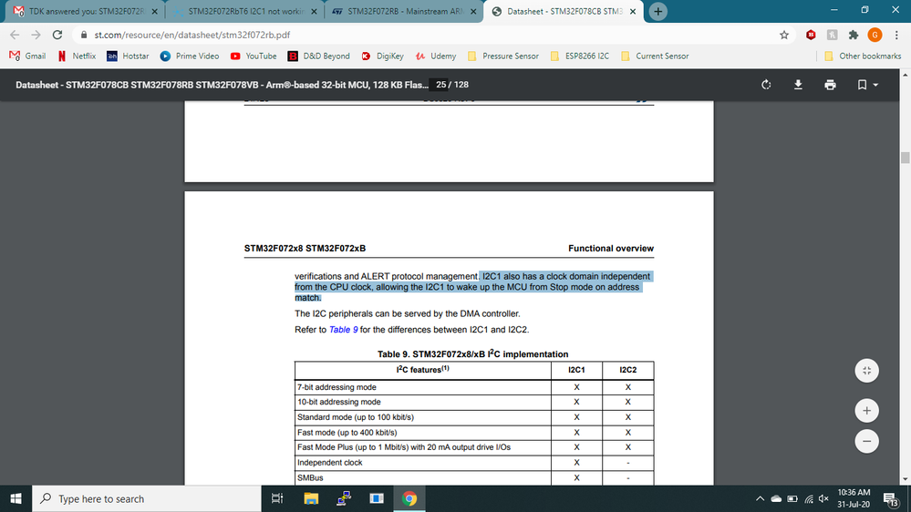

I am using STMCUBEMX 5.2.1 to initialize the configurations of my STM32F072RBT6. My application requires the use of i2c1 since i2c2 is already occupied on our board by a pressure sensor. However, it seems to me that i2c1 is not working (i.e. the MCU does not reset).
I feel it has something to be with i2c1 being used to take MCU out of the STOP condition. I'm not sure how to go on about it since I'm new to this.

> I already have a working i2c2 hence I'm sure I'm not doing anything wrong
It's unlikely that ST fielded a chip with an I2C peripheral that just doesn't work. The problem is likely in your code.
Try it out on a minimal example to convince yourself that I2C1 works just fine. And if it doesn't work on a minimal example, post the code here.
Make sure the I2C1 pins are free and only tied to other I2C components on the board.
Why would I2C1 reset the MCU?
‎2020-07-30 10:19 PM
I was looking through the datasheet and found this. Maybe I wasn't able to put in words properly about i2c1 being used to reset MCU.
Also,
I'm posting the code I'm using to read.
The same thing works if I connect the sensor on i2c2 line and change the hi2c1 to hi2c2 in line 60.

If the i2c1 is pulled up to 3.3.V (with 4.7k resistors) on the board, the code does not even flash in the MCU.
It still stores the old HEX file.
Once I remove the pull up resistors, I'm able to flash the code, reset it from Keil Debug mode and then Run.
I hope there won't be any miscommunication.
Thanks in advance!
Yaagyanika Gehlot.
