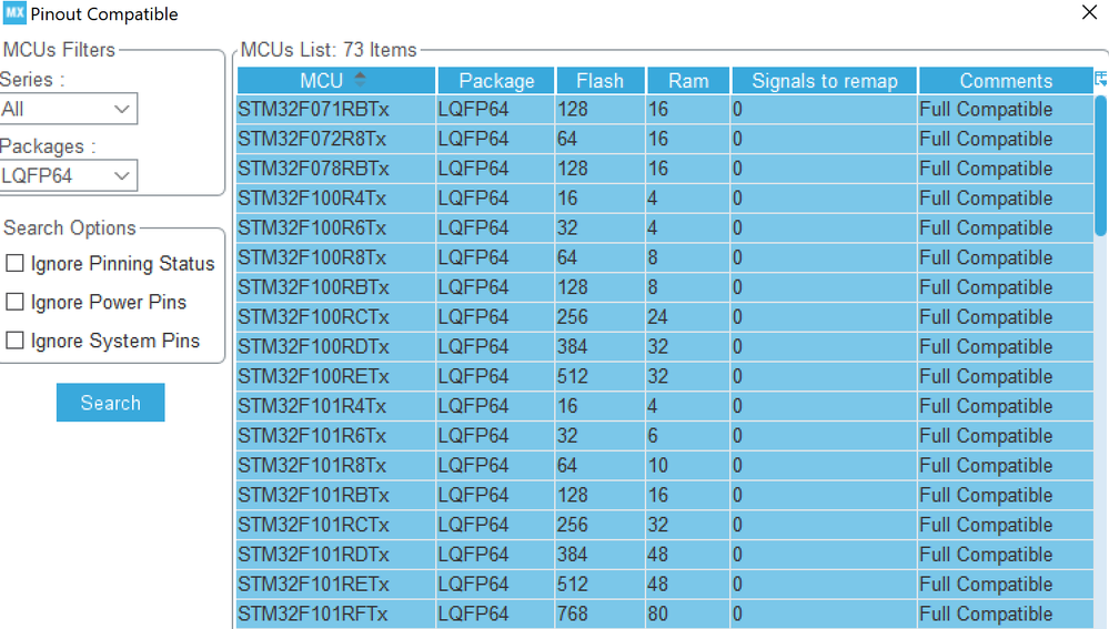

I am looking for STM32F072RB part no but currently it is out of stock and not available anywhere.
Can somebody provide alternative part no which is available easily.
Please share the source details .
Any help would be helpful.
Thank you.
You can use the find pin compatible chips feature in CubeMX to find an alternative, if one exists. It's going to depend on your pinout.
Here's a partial list, which again, may or may not be valid for you based on your pinout.
Note also that "STM32F072RB" doesn't define a chip, since there are two different packages with that part number prefix.
