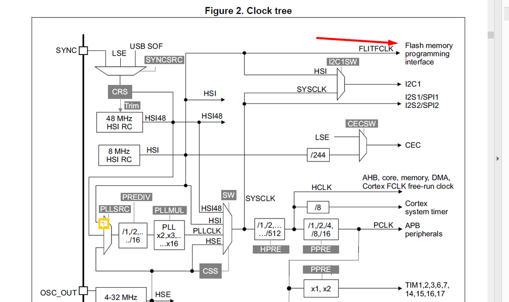

HI i got a problèm on an stm32f0.after a reset the µC is at 8mhz but i'm only able to climb to 16mhz when i want to go to 48MHZ , did someone have idea of where does the problem come from.
the µc are not new because i work on protoboard and i cant change it.

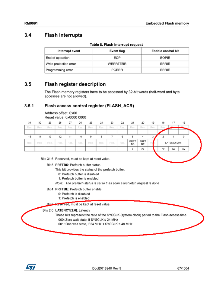

> and how do you change the flash latency?
0693W00000LyR7cQAF.png0693W00000LyR9JQAV.pngJW
What is this, SPL?
What is "climb"? What happens if you "climb" higher? How do you verify the system clock?

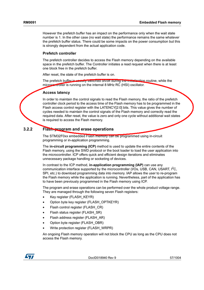

Are you or the "libraries" you are using aware of the fact that you have to change FLASH latency setting (set waitstates), if you want to go beyond certain system clock frequency?
I'm french so i'm trying to be the more clear as possible ,
i use the stdperiph given by ST,
i got a timer with a blinking led , whatever i do with the PLL multiplier i got the same result on the led
I finaly succeed to set a 48Mhz clock but now the code seem work only in debug is latency can cause that problème?
i'm trying to change the latency to see if it work
OK i finaly found how to set the latency and that seem like to work
thank you for your help waclawek.jan  ,have a nice day !
