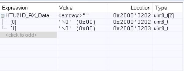

I am using stm32f1 and HUT21D sensor (Temperature and humidity sensor). The sensor use i2c for communication.
I am using IAR and cubeMX.
For cube: I used default setting for i2c.
For IAR: I shared the main.c below.
Can anyone help on why only get 0.

Does the function return an error or success code?
If HTU21D_RX_DATA is filled with a different data pattern, does it return that?
That would be indicative that the device is not responding.
Check wiring, pins used, pull-ups, and slave address

Slave address, and register address look correct, is it timing out, or not responding at all?
Have you scoped the pins?

It works fine. No timing out or any error in debug but the return of the HAL_I2C_Mem_Read is HAL_Error.

I used the debug and I didn't get any errors and I only get zero.0693W00000LyDsPQAV.jpgI checked the pull-ups and the slave address is 0x40.
It seems okay.
The data sheet for the sensor is attached below.

The array defaults would be zero.
Any other registers in the part readable?

What does HAL_I2C_MemRead return as status? (stat = HAL_I2C_Memread(...) )

It show HAL_ERROR

It seems that one the capacitors was not correctly soldered and it change the ground. it works for now.
