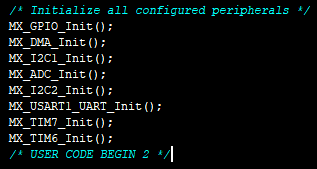

I'm using the cube for generating code for IAR
there is an ADC with to a DMA
the MX_ADC_Init() fail, can't tell why

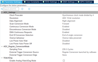

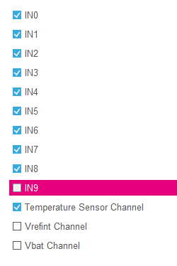

the ADC configuration:

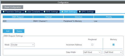

the DMA configuration:

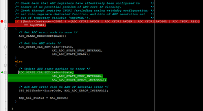

when i run the code, the fail point is:
i have checked that the DMA is initiate first and then the ADC

2024-04-16 2:56 AM - edited 2024-04-16 3:16 AM

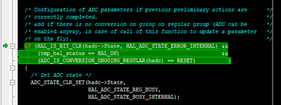

I have investigated the fail handle, the first time that the MX_ADC_Init() fail is after the assertion of the parameters:
at the stm32f0xx_hal_adc.c :
i can only guess that there is an issue implementing the parameters into the ADC
