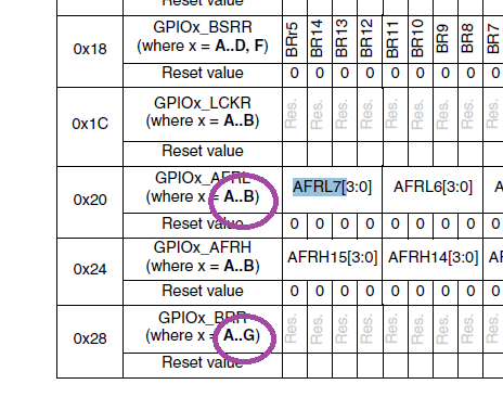

Hello, I try to make I2C on PF6/7 on the STM32F051C6  (48 Pin device) working.
To get what AF to use, Ref man points to the datasheet. But the datasheet is not clear to me, it has a AF Table for PortA and PortB
and  Table 13 Pin definitions  says
PIN 35 - - PF6 I/O FT I2C2_SCL
PIN 36 - - PF7 I/O FT I2C2_SDA
I tried AF0 and AF1 but the chip let me in the dark.
The code I have is working on the STM32F0-discovery
with I2C1 on PB6/7.
Any ideas?
The chip only supports GPIOx_AFRL/H on ports A and B so doing anything of port F would be impossible/inadvisable.
Just set the pins in AF mode, and don't change the PinSource muxing.
Set the pins as OD, and use external pull-ups.

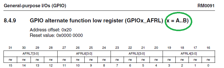

But can you tell me where you got this info from, that GPIOx_AFRL/H only works on Port A and B.
It's marked in a couple of places in the reference manual in terms of scoping when the registers are valid.
