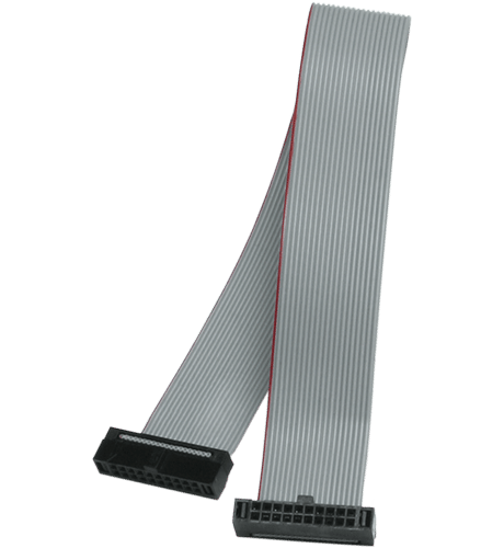

We want to take the Code Coverage report . We are using Ozone IDE and loading the .OUT file to the OZONE IDE .

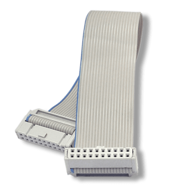

There are 2 cables that are connected to the J-TRACE pro one with normal Segger connector 20 pins that also comes with Segger J-LINK the image is shown below for this cable , this is what I am connecting to the custom board .I know this does not carry the TRACE signals .
To get the J-TRACE Pro working there is cable shown above This connector is a 19-pin connector (0.05" / 1.27mm). It connects to the target via an 1-1 cable. the connector width is smaller compared to the J-Link Connector cable shown below .
I need documentation for STM32F051 which pins should be connected to the TRACECLK , 4 of TRACEDATA pins of the SEGGER J-TRACE Pro

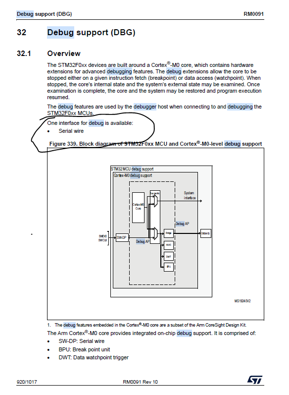

Same issue, it seems like no J-TRACE option
Reading RM0091 page 920, only serial wire is supported

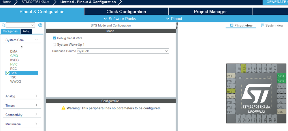

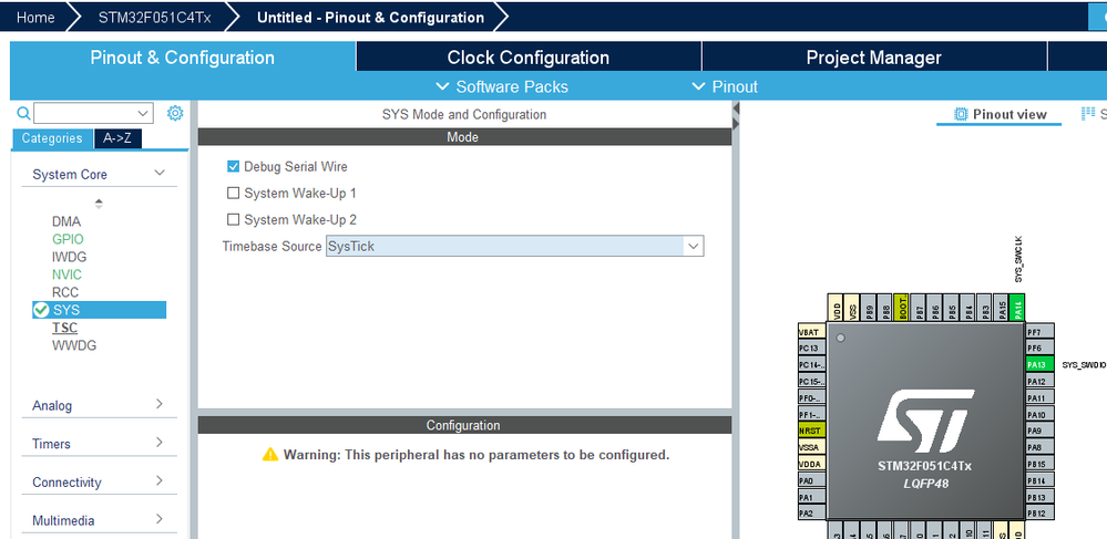

STM32F051...
we need the specific packaging if you want specific pinout
for example :
STM32F051C4T6 (LQFP package)

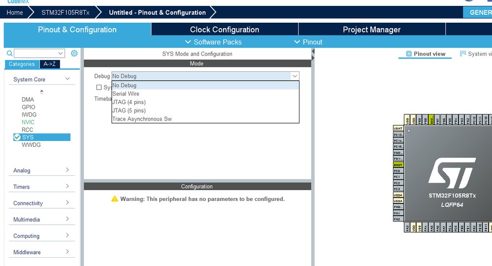

I dont have any experience using jlink in this mcu. Are you sure Jlink debugger is supported?
CubeMx doesnt show the jlink option for debugging
But it does show the jlink option for example in one of the chips im using stm32f105
‎2023-02-07 2:54 AM
The package details for the MicroProcessor "STM32F051K6U7" UFQFPN 32
STM32F051K6U7 NEC Tray UFQFPN 32 5x5x0.55 mm
‎2023-02-07 3:17 AM
